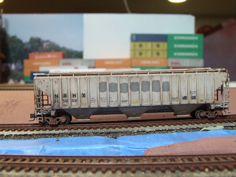

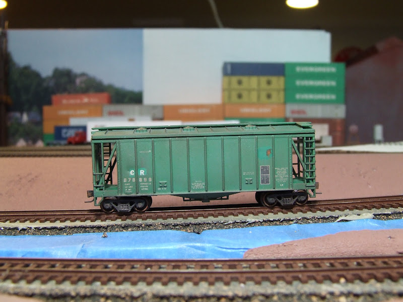

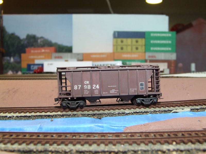

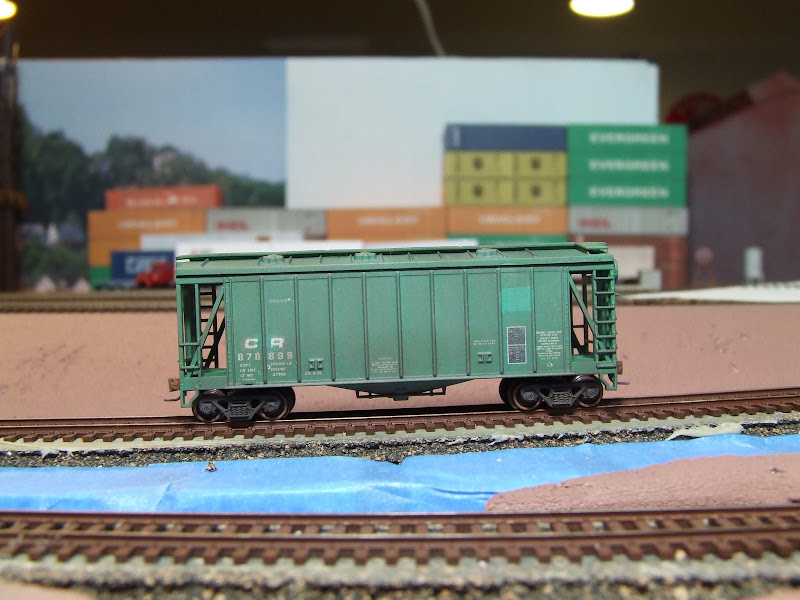

Those cans are great. I have been patching and weathering some covered hoppers.
