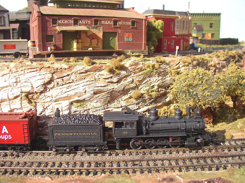

This stuff was done about 40 years ago.
Here's a rock cut that has been drilled and blasted to get track clearance:
[img width= height=]http://lh4.ggpht.com/Gregg.Mahlkov/RmlsLkzEerI/AAAAAAAABbw/qBoGQKQ3PTg/s800/FreightwithH3-2.jpg[/img]
Some more sedimentary rock. I carved the rock faces, but I was a lot closer to my geology classes in collge back then. ;D
[img width= height=]http://lh4.ggpht.com/Gregg.Mahlkov/Rm1ZlkzEfEI/AAAAAAAABfE/HTv5KWdn2WQ/s800/OilDepot-FrtHse.jpg[/img]
This is more recently ballasted track on my photography diorama. The track is Atlas code 80, with Highball ballast and WS cinders.
[img width= height=]http://lh4.ggpht.com/Gregg.Mahlkov/RmXP4kzEckI/AAAAAAAABI8/aE90Yb8NP4Q/s800/NYC304-three.jpg[/img]
