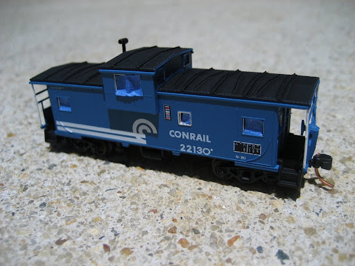

Up next is an N scale Atlas extended vision caboose, Conrail class N20 #22130:
Built by the International Car Company in 1970 for the Reading Railroad, Conrail's class N20 cabins (ex-RDG 94100-94109) numbered 22130-22139 were among the most modern on the Conrail system. They appear to have received their blue paint almost immediately after the April 1976 Conrail startup. Nevertheless, they weathered quickly.

Sometime between 1979 and 1984, several of the windows on the N20 cabins were blocked off and painted with a non-matching blue. At that time the ACI labels were removed or painted over. Since I'm modeling 1980, I decided to leave the windows intact.
Here's a shot (unknown date, from hebners.net) of the early configuration with all windows intact and ACI labels (near the cupola).
http://www.hebners.net/cr/crN20/cr22131d.jpg
So step 1 was adding the ACI labels.
Step 2 is masking the windows. This is tedius, and not necessary if you want hazed-over windows. In fact, prototype photos suggest the windows were pretty filthy by 1979, so you could save yourself some time and skip masking before the Dullcote. If you choose to mask (I'm a neat freak) you can use painter's tape; cut the masks to size with a new #11 blade. Then Dullcote.
