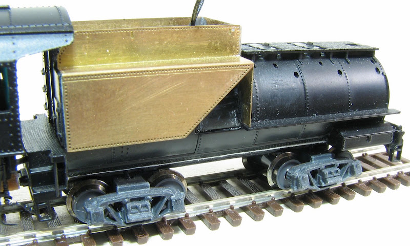

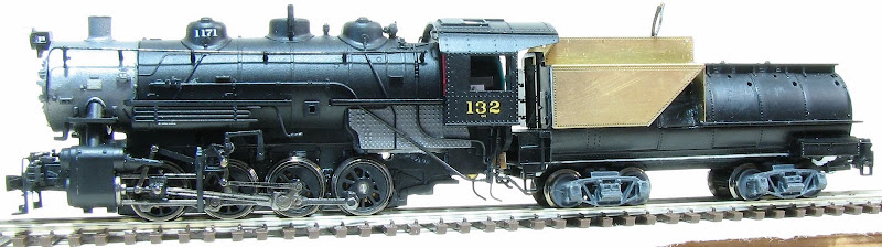

Worked on my 0-8-0 tender:
Had to swap out the completely useless MP trucks for Kato caboose trucks, the sideframes are cut from a Con-Cor 2-10-2 tender.
I don't "love" this tender, but it is what the C3's used. I can still wuss out and use the stock tender to model a C1 if needed.

Why is it that everything Chris does comes out perfect . Hey Chris , do you have any shots of flubs ?

Richie,
The flub would be the tender truck sideframes being too thick. Usually gluing sideframes over the caboose trucks work because the truck is tucked away under a car, but this round tender really shows it off.
In case any one wondered. I cut the contact tabs off, soldered wire to the back sides between the wheels. Then I drilled holes in the bolster and ran the wires up through there and into slots cut in the body.
