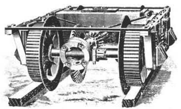

I've got a lot of C80 on completed layout portions.  Anything that gets upgraded gets Peco C55, but a lot of C80 remains.
I've learned not to stress out about LP wheels either.  It's all a matter of selecting the right prototype:
