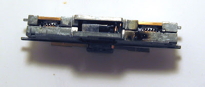

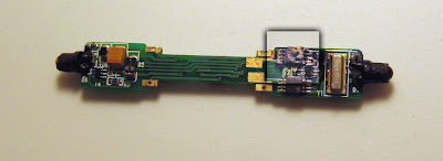

I decided to go factory installed a few months ago after I had to fight with the dreaded Atlas brass contact "fingers" on a DN163A0 installation.
However, since then, I've had one factory installed decoder fail spectacularly (there was smoke and charring on the chassis and shell) and two go quietly (just not responding).
As much as I hate monkeying with Atlas decoder installs, I'm going to go back to buying separate decoders.
