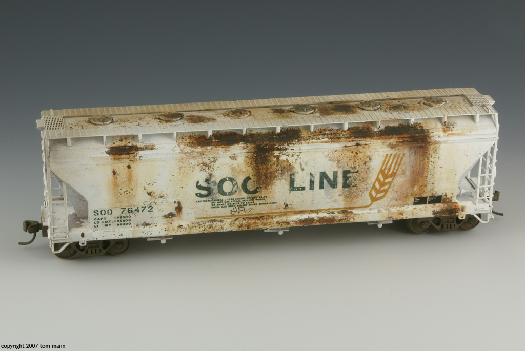

I'm working on a replacement technique for using Krylon Rusty Metal Primer for surface rust. This is the first, using Sophisticated Finishes:
In the future, I will have the results of rust cultivated from the inside of a coffee can, and rusting steel wool in vinegar.  The end goal would be to use no paint!
Thoughts?

« Reply #3 on: January 02, 2008, 09:32:58 PM »
How did you get the rust to look pitted?
Re: New rust experiments
« Reply #4 on: January 02, 2008, 10:26:36 PM »
It is the activator chemical that does that.  I didn't have to do anything special.

Re: Dr. Tom
« Reply #7 on: January 03, 2008, 10:37:07 AM »
TOM!
 Just an opinion...I'm don't like it. What a mess! I do respect your constant
urge to experiment and grow as a weatherer but the stuff you were doing with
salt was WAAAAY better.
 Thanks for reading my response! Hehe. You are the mad scientist of rust!
Jeff (MrKLUKE)
Hey Jeff,
Anything specific that you don't like?  I think that the SophFin is too textured for use in HO scale.  It makes the rust look like it's rusted through - too heavy in my opinion.

you can just place the cap on the jar and it will keep the smell in (I use an old Mayonnaise jar with a plastic lid (metal lid doesn't work the greatest)
Also with respects to the SF did you paint the car afterwards? The paint on the roofwalk looks really thick... (Kinda like an old anode rod out of a hot water tank :))
