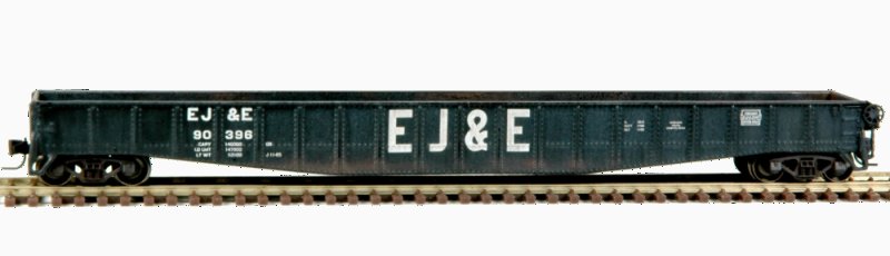

These gons are pretty scary out of the box between the glossy paint and the huge rivets.  A little dirty, and a little dullcote seems to tame those problems enough to make it layout-worthy.  I ended up carving away the bolster on the truck to lower it, rather than messing with the one on the body.  Athearn uses those shouldered body bolsters with a screw, and I didn't want to modify that... so there's about half the thickness removed on the truck side.  Brought the body mounted couplers to the right height, so I'll leave it at that.

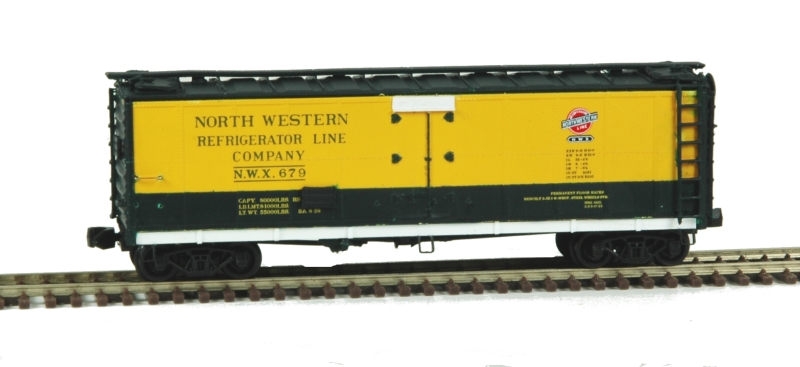

Also started on a pair of NWX reefers from Intermountain, trying to make them a little closer to the Renton rebuilds they're supposed to emulate:
New side sill, shortened doors, scribed and riveted belt rail added, etc.
The problem isn't that the rivets are too big, the problem is Athearn painted them by dipping them in gallon cans of latex paint. Actually, it's not latex, because I had to use commercial-strength paint stripper to strip the one I have. But if you do go to the trouble of stripping one, you'll see that the detail on those cars is actually rather decent:

  • Posts: 5417
Above is a quick shot of one I stripped and re-painted.
Hey, look at that.  They really are rendered crisply under all that paint.  Nice.
