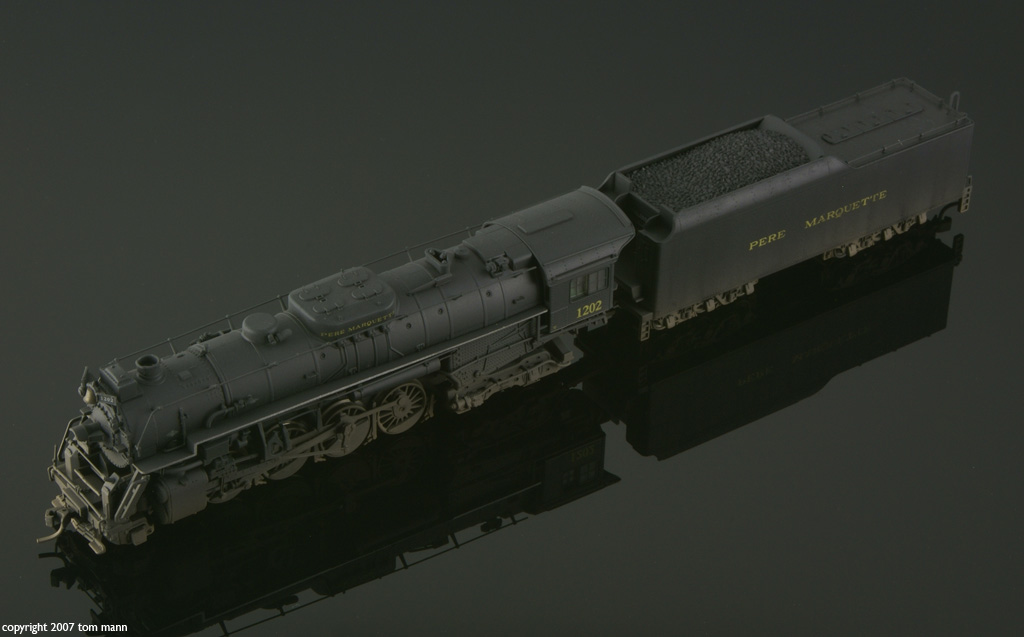

Last week has been "steam week" for me.  I'm weathering 4 steam locos in 3 scales!
The problem is, since I'm not too experienced weathering steam, I don't know when to "stop".   Since steam had to be frequently maintained, there wasn't a big opportunity for much weathering to happen between shop time.
Thanks to Erik for sending me the landmark 1980 Gazette article.  I followed the advice in this article, with slight changes of paint.

So did you take that thing apart to weather it, or did you do it in pieces? Once I figure out how to get my damn Bachmann Mountain to run right, I have to hit that with an air brush...
A-Town Hump
"I believe the technical term for you would be 'a$$hat extraordinaire'."
Re: Subtle steam weathering
« Reply #2 on: October 26, 2007, 02:14:25 PM »
No need to take it apart.  Just set up a little track and run it back and forth while the airbrush is 8" away.
« Reply #4 on: October 26, 2007, 06:50:04 PM »
Tom-
I think she's a beauty! Good job.  ;D
The problem with steam is trying to find some other colors to drop in so everything isn't just black.
I actually designed my paint scheme to have oxide roof and tender deck just to get a little color in there.
Some steamers had sand spills, hard water stains, and even rust. It just depends on the life of the unit.
The only suggestion I can make is to cover the molded coal load with a thin layer of scale coal.
Good luck finding some! The WS stuff is actually charcoal, so grinding and sifting real coal is probably the best bet.
You don't need much to do the job, though.
Thanks for sharing pix...

« Reply #5 on: October 26, 2007, 07:31:35 PM »
Nice effect; the tender is especially good. I think subtle can be harder to pull off than the more seriously aged. My suggestion (other than the coal as already noted) is to try adjusting the coloration of the siderods and, in particular, the valve gear. Even on the most bedraggled steamers, the valve gear was clean and shiny, as they were usually slick with lubricants, and the siderods seemed to get less dirty than the wheels.
« Reply #6 on: October 26, 2007, 09:16:07 PM »
I disagree as to the rods and valve gear. Here's a photo, albeit in black & white, of an NKP Berkshire (709):
[img width= height=]http://lh5.google.com/Gregg.Mahlkov/RmCUi73tfgI/AAAAAAAAArs/4ZUwibypaCg/s800/NKP709.jpg[/img]
To me, it seems the only shiny part of the rods is the piston rod itself, everything else has a pretty uniform coating of grime. At times, the rear drivers were lighter in color, due to ashes being dumped from the firebox behind them.
I've been looking at a lot of steam loco photos over the last two months, and you are right - but for a small percentage of them.  It all depends on the frequency of maintenance and when the photo was taken (ie, right after a shopping).
I'm sure there are plenty of examples to support either view. I reviewed about a hundred period photos before making my post, and seldom where all of the valve gear and rods a uniform tone that exactly matched the wheels. For instance:
Or, something a bit closer to the subject:
Obviously Tom did his homework and I imagine the information supported his view. I was merely presenting an alternate view based on my own observations.
