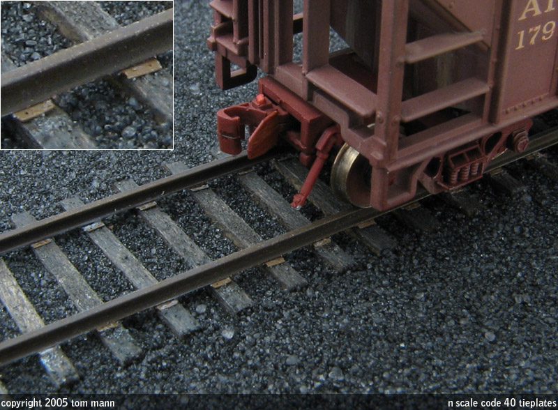

You may want to look into the tieplates from proto87stores.com:
http://www.mannresearch.com/rr/track/track_11.jpg
Caleb Austin

Re: first stab at handlaid track
« Reply #17 on: October 22, 2007, 09:38:53 PM »
I might tryout those tieplates but, man they look tiny :o
« Reply #18 on: October 23, 2007, 11:56:14 PM »
Yes, they are tiny & hard to work with.  Also I've found that if you don't paint them a contrasting color, they can blend in with the ties and nearly disappear.  Here is a sample I did, the tieplates look OK in the photo but I find them a lot harder to see in-person (but maybe that's just my aging eyes).
http://f1.grp.yahoofs.com/v1/MLUeR43MflvfPldoAQ11DddGs6fvOkSuV3qDzpFZuTscyrpQMIDgLAea-3IP3HgAjNvqPAp4HcjUEwjeiPft05qCPplhXV-k/Ed%27s%20Hand-spiked%20trackwork/100_0063-cropped2.jpg
BTW I used the ME ties, but those seem to have a lot of variance in their dimensions.  Tom, which ties did you use?  They look really good.
PS - if you guys arent on the N_finescale group on Yahoo, you really should consider joining  :)
« Reply #19 on: October 24, 2007, 12:09:38 AM »
yeah the lack of spike heads is annoying but I find it less noticable than oversized plastic spikes.
Scale spike heads would be pretty hard to see in 1/160 scale -- around 0.005" or so.  I think we all get kinda used to looking at the oversized ones on commercial flextrack.
Even the 1/87 scale photoetched spikes from http://www.proto87.com/ are kinda hard to see -- They're even hard to pick up w/o a tweezer (tho the elongated ones are easier to work with).
« Reply #21 on: October 24, 2007, 07:28:56 AM »
Thanks - I can't remember, but I got them from Proto87stores.com.
