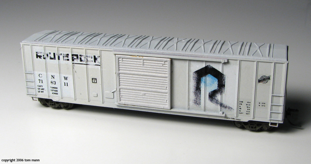

I'm always on the lookout for innovative decal ideas.  Some of you might remember my z scale CNW ex-Rock decals from last year with the fading done in Photoshop at the artwork level: http://www.mannresearch.com/rr/ri/zscale_rockbox_02.jpg
