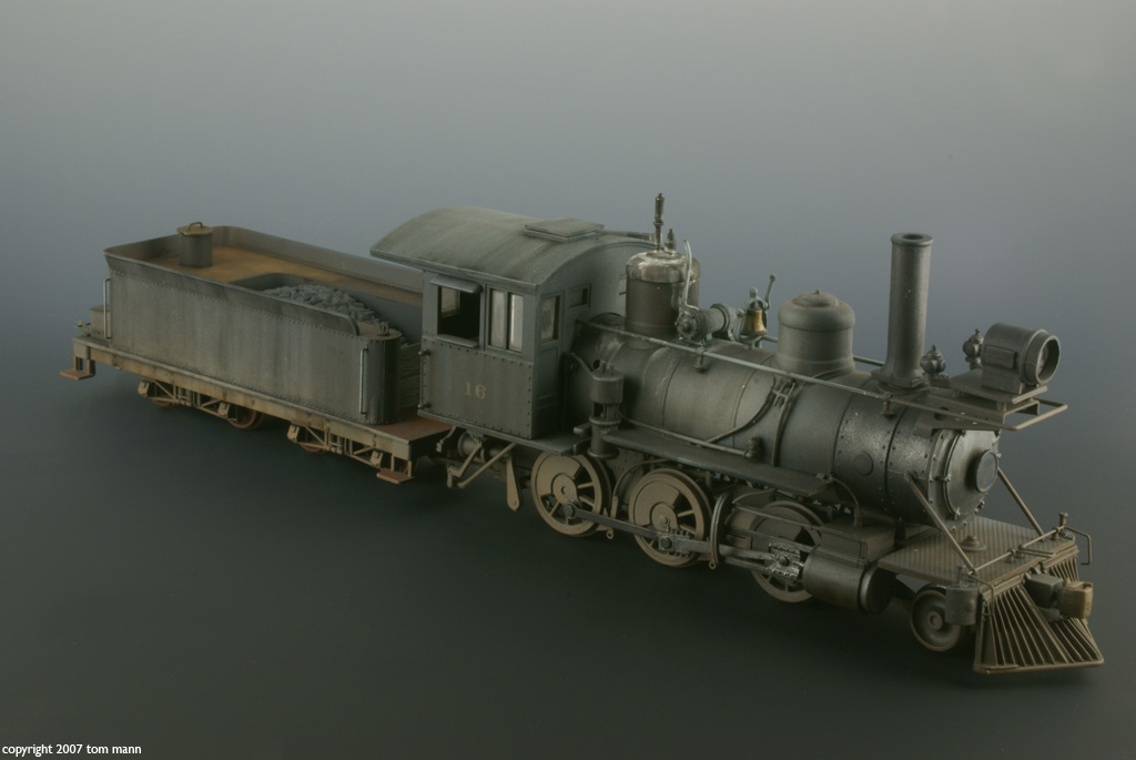

Ok, after a few more hours:
I used neolube on the smokebox, rods, and stack to get back that graphite look back.  I was trying to get a 'water stain' effect around the second dome, but am not sure a water stain would even be there.
What is that little pot with lid behind the coal used for?  For cooking crabs? ;)

that looks good but the coal...
...the coal looks weathered too - shouldn't the coal be black, I mean real black ? how often do they fill up coal ?
I'm going to replace the coal with wood.

Tom, the "little pot with the lid" on the tender deck is the water hatch! The tank spout is stuck in it and turned on. Yes, there would be lime stains around the whistle and pop valves on the steam dome. Look very good, BTW. Same should be around valves adjoining the top cylinder of the air compressor.
ok, I see...   ;)
...and when do you replace the smokestack then ?
(if you burn wood you need another chimney...)
