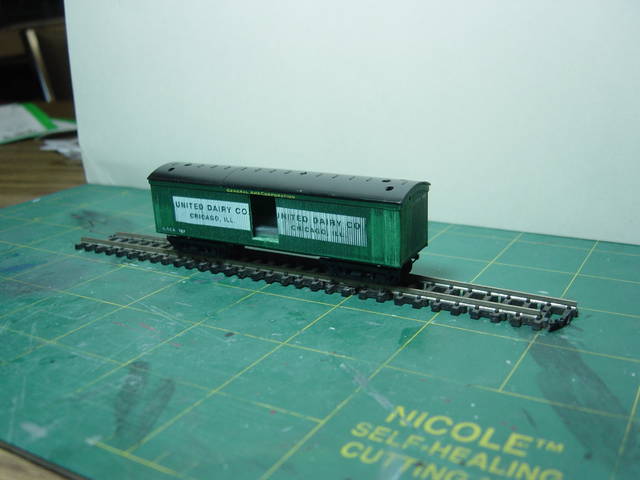

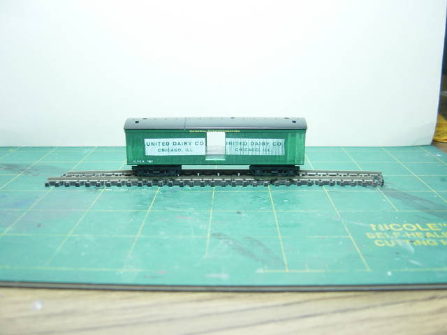

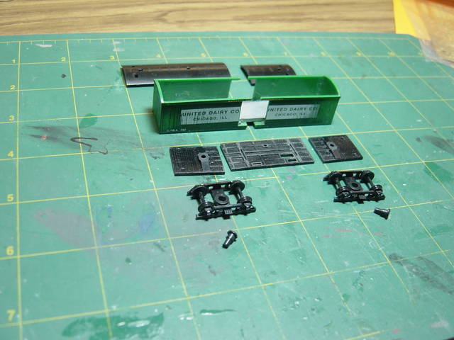

  Continued working on the milk car this past weekend at the N-TRAK club's Back Shop and managed to grab some in-progress photos.  I could have done a little better job on trueing up / sanding the body joints but it was my first n-scale kit-bash attempt. Hopefully this will get hidden with a small quantity of putty along with the final paint job - pullman green. Also gave it a quick spray-bomb primer coat to see how the scribed siding looked...I'm not too happy with the results, but we'll press onward.
At this point I will be using GMM etched metal parts for the grab irons since I finally found them in my parts box. The side & small end doors will be fabricated out of Evergreen styrene and one of my Micro Train or Intermountain cars will become the "donor" for the underbody brake details. The roof still needs alot of work before it's complete.

Paul Ohegyi
Current Member
https://nrmrc.org/
Frank Amato
  • Posts: 1407
  • Respect: +930
Re: DL&W wood milk car details
« Reply #5 on: June 06, 2007, 08:17:10 PM »
Looks great!  What will you be using for lettering?

You should be able to get either MTL or Intermountain underframes as separate parts if you want to avoid a "donor" car.
Not a collector so the concept of hacking up a perfectly good model felt kinda good, BUT...your suggestion forced me to perform some additional scavaging in the old parts bin & I found some of those Micro Trains & Intermoutain brake set parts. Another MT car barely escapes the kitbashers knife  :'(
