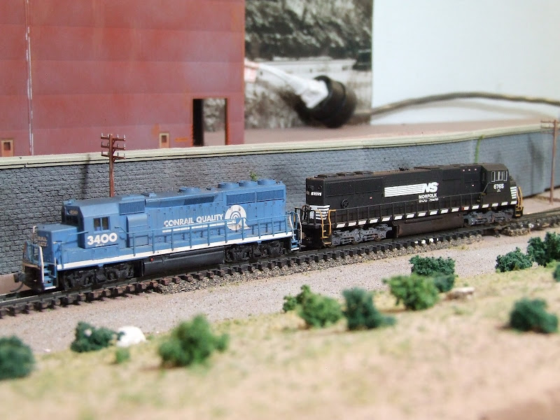

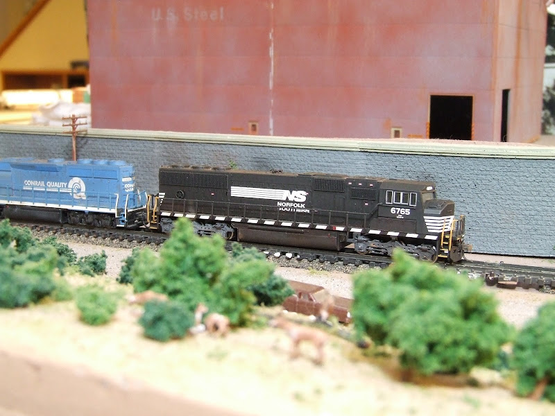

txronharris
Re: How do YOU weather a Diesel road switcher?
« Reply #13 on: April 29, 2007, 02:30:31 AM »

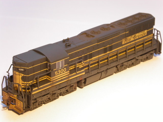

For this D&RGW SD-7 I first lightly airbrushed the lower portion with Polly Scale Dirt, including the trucks, which were sprayed separately.  I then airbrushed Polly Scale Grimy Black directly down from above.  I used washes of rust on the couplers as well as on a spot or two on the body.  I then sprayed the entire thing with Polly Scale Flat Finish.  I used soot colored Bragdon Weathering Powder on the roof, ends and a few spots on the sides.  Lastly I used Polly Scale Engine Black for fuel tank spills on the sides.
Erik
« Last Edit: May 11, 2007, 04:15:20 PM by Erik W »
