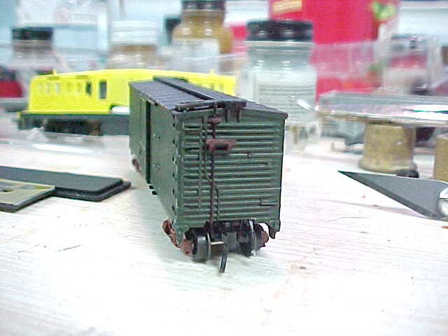

No decals yet, but here is an end shot:
Although technically a boxcar, during the fishing season these cars carried iced-down fish.  If ever we needed a smell decoder for a car, this is it!
Once I get the tackboards and a few other odds and ends back on, and once I get the decals, this will be NS No. 180.
Here's a question:  where do the steam and electrical lines go?  This IS a piece of head-end equipment, but I don't have a good end shot.
I am going to model the green mold common to old wood of this area by drybrushing lime green onto the lower areas, maybe make a wash out of it for the cracks.  It will get plenty of rust on the metal, as it did spend some time near the ocean.
