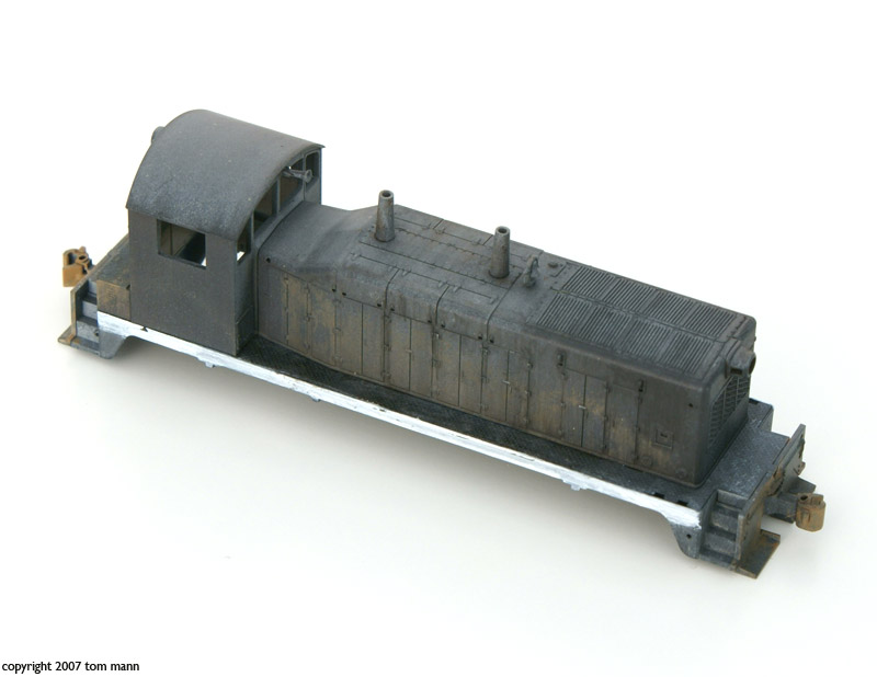

Here is an look at my latest, but unfinished work:
I'm working on techniques to make weathering black a little more, well...less difficult.  The key is a nice dark neutral gray color as a base, with layers over top of it.
