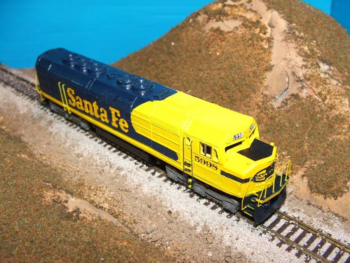

April 09, 2007, 07:55:43 AM »
SirTainly
Posts: 1785
+93
Re: crap modelling from downunder
Reply #21 on:
April 09, 2007, 10:04:20 AM »
it lives!!!
Looks very good, other than couplers and a horn, what's left to do ?
kiwi_al
Posts: 1481
+473
Reply #22 on:
April 10, 2007, 05:46:23 AM »
Oh not much - hmmm......... Fuel tank, trucks, aircon, flicky light and sinclair antenna, window glass and windscreen wipers and light weathering!!
