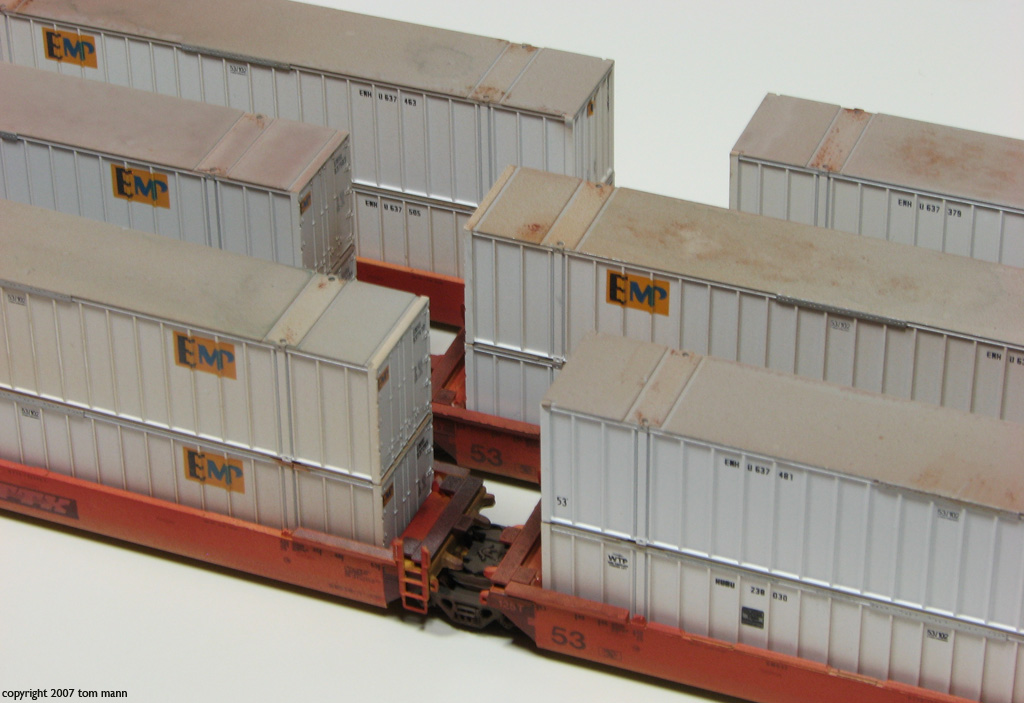

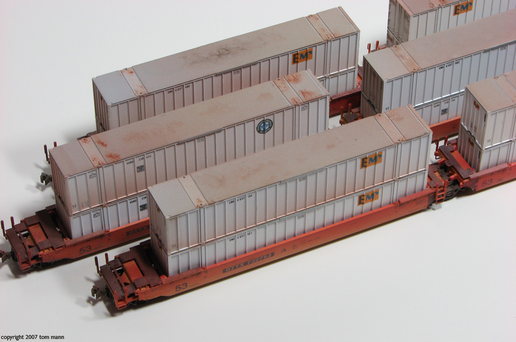

I've been working on this for months, off and on.  I have a bunch of nice photos that I took from Cresson, PA, when two container trains stopped for a three way meet.  I noticed that for the most part, they are pretty clean, save for a even coat of red, dusty, rust.
I'm not a fan of container trains, but I am a fan of the models.  Kato did a nice job with these.  The metal/plastic compound is great, and the magnetic containers are even better.
Hope you like them.

Nice job, Tom.  I like the way your "dust" blends the yellow and black together.  Did you airbrush it or use chalk?
  Frank
Re: maxi stacks
« Reply #2 on: January 15, 2007, 10:34:25 AM »
I first airbrushed a coat of white/earth mixture to tone the black lettering down.  I followed this up with some Oxide Red/Roof brown.  No chalk.

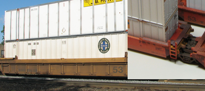

Have a photo of the prototype?  Most of the stack trains I see are headed North on the CN out of Chicago, and all that TTX equipment gets filthy with grimy black.  Haven't noticed the red ones in this part of the country.
Re: maxi stacks
« Reply #4 on: January 15, 2007, 07:01:53 PM »
Not exactly the same proto, but the same color I was going for.  I should have mixed in a little dirt or something, I don't know.  It's a hard color to mix.

Like Mike, most of the filthy double stacks I've seen are more of a grimy black colour.
Maybe it was a 'local' effect that resulted in the reddish rusty dust you saw.... if so, you've nailed it.
Overall though, I think they're a bit too red/rusty for your typical TTX Maxi-IV.  :-\
Yeah, there's no red at all in that proto pic.  Grimy Black in Dust, and a few drops of Earth would get you there.  But stay away from the rouge.

First off, great job...I don't think you're as off base as you think.
I think it depends on where the cars run most of the time.  If you go out on the BNSF Transcon, you'll see more of the reddish weathering because of all the red soil in Oklahahoma. (and TX, NM, AZ, and CA as well to some extent...but more sand that doesn't stick to the cars as much)  Obviously intermodal cars aren't in captive service--but it's not total chaos either.  I've noticed at least some cars that seem to show up fairly often on the same route/train so I think they do develop "local weathering" to some extent.
Also, the base color of the Kato cars may be unforgiving with the red.  A slightly lighter (faded) yellow might have been a better starting point.  Finally, I think you have some lighting issues at work there as well...it would be interesting to see the stock Kato cars in that same light.

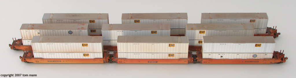

Tom that's not a hard color to mix, compare this to your proto photo:
The mix is black, white, raw umber, raw sienna, and some raw umber pastel added to thicken the wash. As for the rooftop rust, remember coule de source... You're getting too confident  :)

Yes, it's the same materials and techniques as the article - except the addition of the chalk to the wash to make it heavier and more opaque. This is the only big change I've made in the past several years, and was mainly due to seeing the results Tom was getting using this same technique.
Here's a shot showing the deck where the wash is really heavy, and a black wash+chalk used to recreate the soot-covered look of a steam era boxcar:
