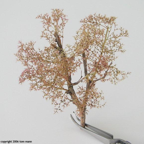

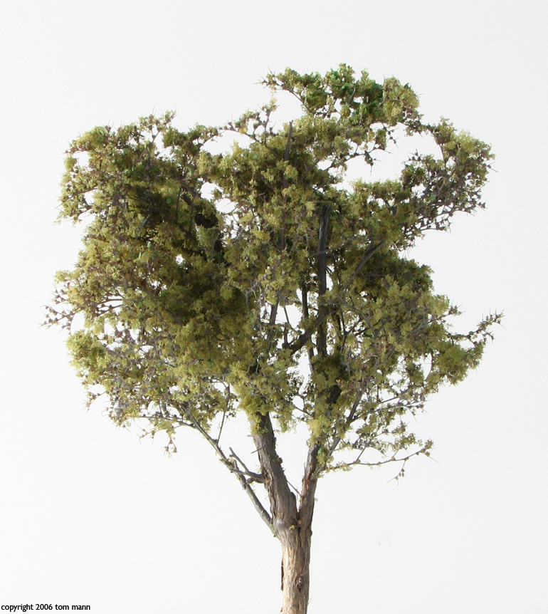

I bought the Scenic Express "Super Sage" kit (recommended for HO and larger
). This is essentially a box with sage bush pieces and whatever the "Super Trees" material is. I imagine that it's stuff that someone somewhere has in their backyard. It sells for $25 - the $40 kit includes a sprayer, matte medium, and ground foam in every color of the rainbow (only good if you're David Popp
It's hard to say how many trees this kit will make in n scale. A lot of the sage pieces are too big to be used as is, but they could always be split. But unless you're modeling redwoods, you'll have to break them apart. The "game" is to attach the super tree weed to the sage in a tree-esque fashion. Easier said than done. I actually split and grafted in pieces, and drilled holes to get a fluid look.
This is how they look assembled:
And painted and all groundfoamed up:
Note that the sage looks too much like a sand-beaten dead tree that you would see in the desert. But it looks organic and barky, too, so I like it. The kit is good for large trees, since there are few pieces smaller than what would be 2 ft in diameter for a real tree.
Last Edit: December 31, 2006, 07:17:02 PM by tom mann
Easier said than done indeed. Same thing I did with my box wood twigs (from my back yard
) It takes lots of practice and patience. I'm still not very good at it. Your trees look good Tom. I think I'll take the Super Trees starter kit material and use it with my box wood twigs. Having a photo of specific type of tree to work from helps a great deal. Same as when weathering freight cars.
