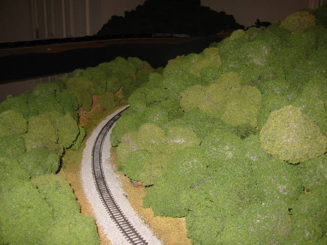

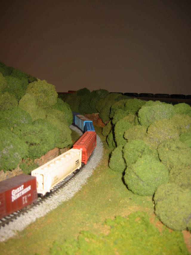

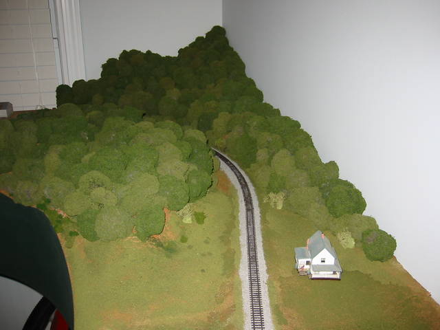

Here's my attempt at +/- 2,500 cheap trees.  The cheap camera and flash sure show the gray polyfiber.
They were created using Walmart pillow stuffing, Reit Dye (triple strength brown/black mix), a lot of very cheap hair spray, and various combinations of Woodland Scenics and Scenic Express turfs.  They cost about $.03 each.  Each tree was completely covered with foam to avoid filling in the "cracks" between the trees.
