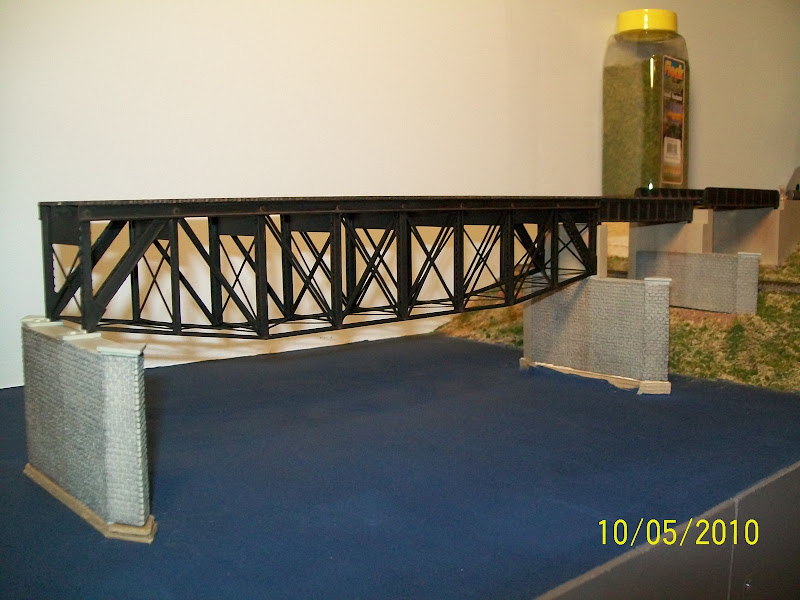

Fellas, thanks for the comments. This summer has been super-busy, so not much progress on the bridge. I can share a few grab shots (apologies for the flash on my daughter's camera). Here is the base color on the Delaware River, looking at the Jersey side:

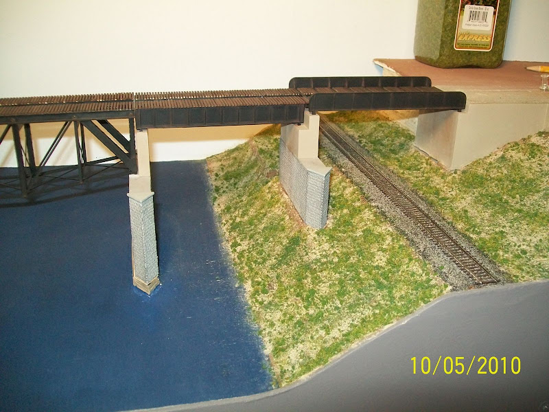

And here's the PRR Bel-Del line, with basic ground cover. I am very unhappy with the dirt color; I am using sanded grout, but it dried *way* too light and looks like sand. Lots of work to do here this winter to gloss the river, add trees, and lots of weeds:

Looking good, in spite of the dirt color. Are you including the canal?

I'm starting one myself I have the CAD drawings and a lot of the styrene cut it is going to be a 250' Camel-Back Pratt I'm trying a new method of construction using clear styrene sheet and taping it over a scaled CAD drawing and then gluing the parts to the clear styrene making sure they line up with the drawing then I cut out the clear sheet around the details. I'll also be using Archer rivets and Gold Medal Models X-bracing. I will be posting my progress this month. The funny thing is it will be an abandoned bridge! It is based on a prototype NYC (former LE&P) trestle that crossed the Conrail Cleveland Pittsburgh mainline. The LE&P was abandoned when Penn Central came about in 68. The bridge stood abandoned till its demolition in the early 90's. But anyway as far as the dirt goes on your layout you might want to try real dirt and ground up fall leaves. I've seen many people use this technique and it looks really good. I'm getting ready to try the technique myself.

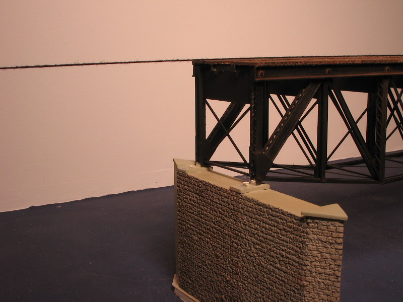

Here's a detail shot showing bits of styrene strip to "shim" each truss level, and the silicone that secures it to the pier:

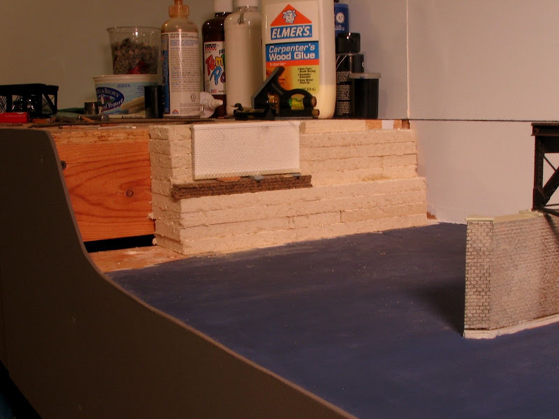

This is the PA side, with the resin retaining wall shimmed, and styrene footings in place. One I lay down the basic hillside scenery, the last truss will be ready to glue in place:

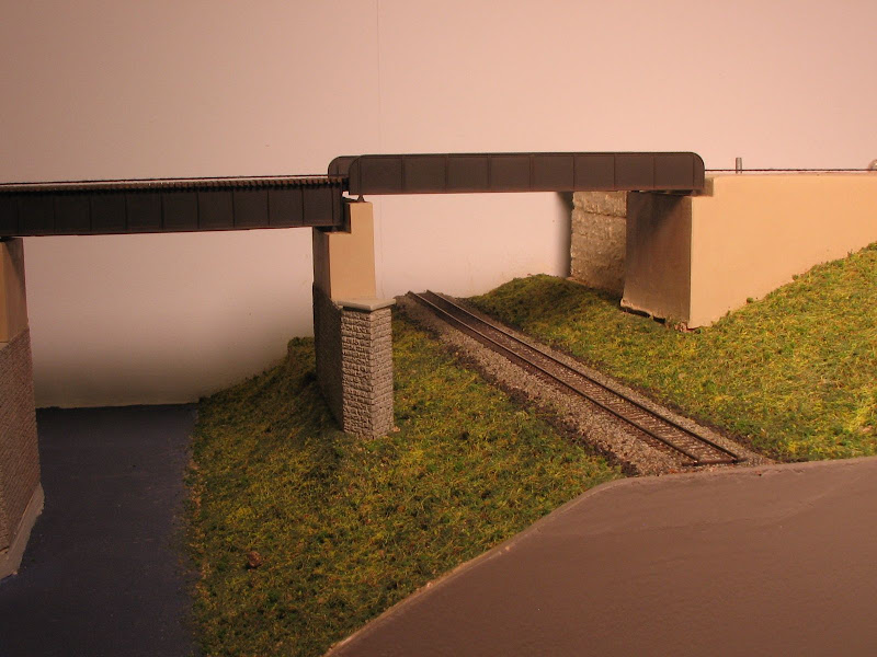

Finally, a quick shot looking North up the PRR Bel-Del. I applied more ground foam and flock, which improves the basic look a lot. This will get lots of trees and bushes once I get rails up on the bridge:
Lots of work to do in the river as well, to hide the shims under each pier, but that's for another day!
