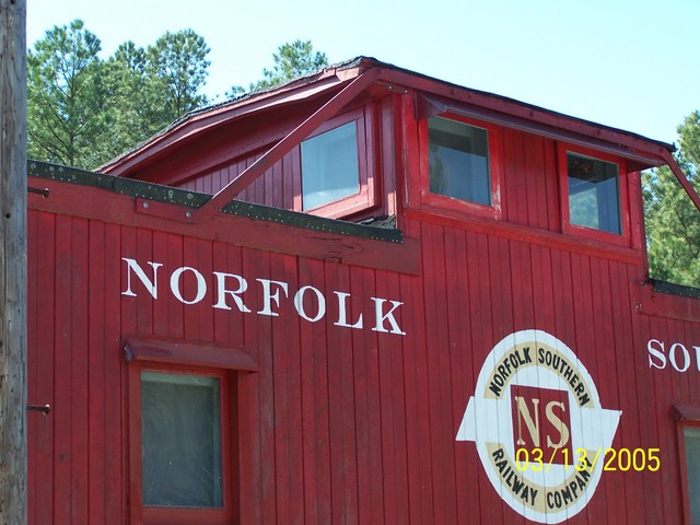

http://www.norfolksouthernhs.org/albums/NS-Caboose-335/CloseupCupola.sized.jpg
Any hints on how to do the cupola braces? They are, obviously, flat and very thin. I could do them with wire very easily, but then they wouldn't be flat enough. I don't think that styrene would be feasable; too easily broken.
diezmon
Re: April Contest
Reply #6 on:
April 06, 2006, 01:45:01 PM »
You can get flat wire as well.. not sure where to find it, but it's out there.
I think I may have even seen it at ACE hardware.

Iain try this site
http://www.ksmetals.com/

Detail Associates sells flat bar like that. It would be right next to the brass .010" wire and stuff like that at the hobby shop.
I don't know what sizes they make, but I have 2 different ones myself.

Couldn't find anything at all that was usable in my case, even on Google. I might just end up going with regular wire.
I am thinking of maybe Atlas brake details. I will have to do my own truss rods. Wire grabs, everything.

I'll get the number off the flat wire when I get home later. I know my LHS carries it and they don't have much of anything.

I save all of my etched brass and stainless steel frets, they are a good source of thin gauge metal.

Detail Associates (229)
flat brass wire:
2522 .015" x .018"
2524 .015" x .030"
2526 .015" x .024"
2528 .015" x .042"
2530 .015" x .060"
