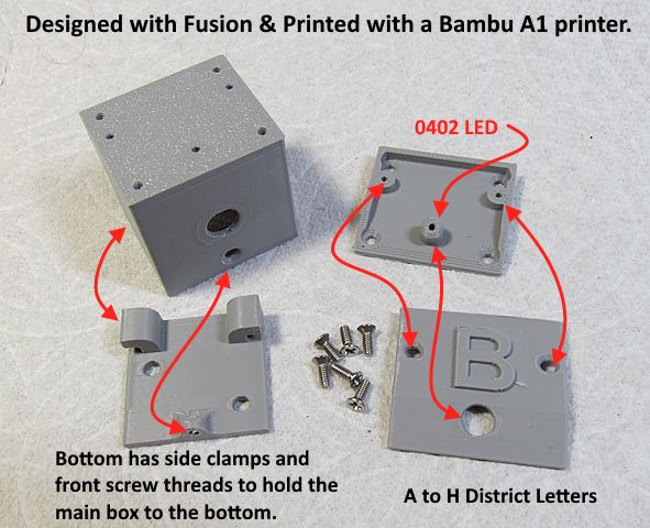

DCC-EX 8 District (A-H) Control Panel ....

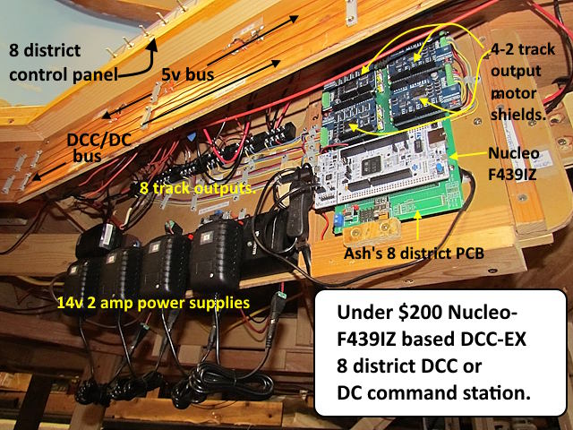

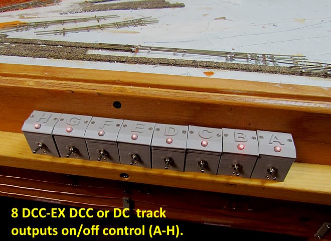

Track outputs on a DCC-EX command station can be powered off with your phone or other throttle or by turning the command station off. I wanted a physical way to turn any of my track outputs in addition to those options. I have an 8 track output command station and came up with the following on/off boxes with an indicator light on each along with a letter representing which output that it is. DCC-EX uses letters instead of number to label the outputs, A-H in my case.
If you need more info that what is in the images please ask.

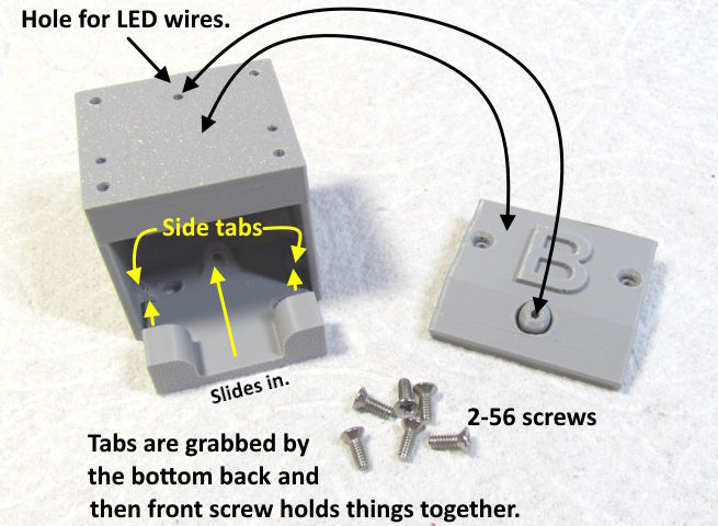

The individual control box was designed so that you could put two screws through holes in the base and screw them into the wood rub-rail that goes around the layout (see last images below).

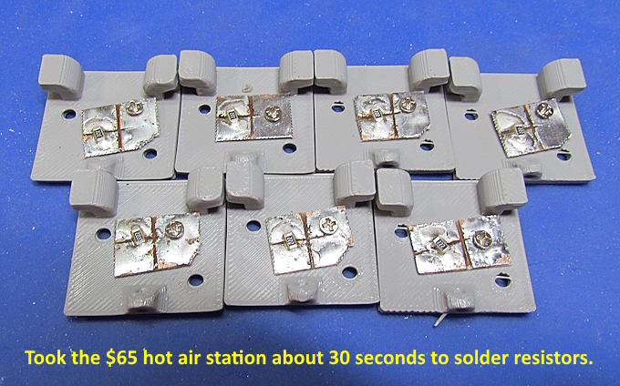

...... 1206 SMD resistors for the LED's soldered on in a minute or less with hot air soldering station.

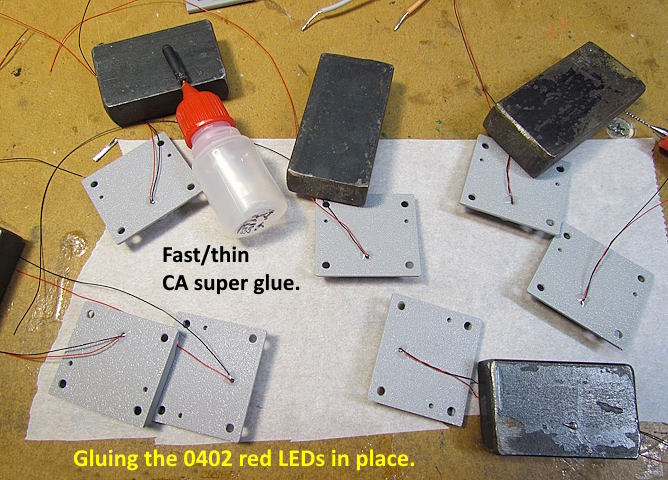

0402 red LEDs were dropped into the holes on the intermediate top and glued in place with CA.
A hole was drilled in the fascia behind each box for the three sets of wires. The track voltage went to the bus used for track in 8 different districts.
Red indicator LEDs are lit when the track output is on.
The eight track outputs from the DCC-EX command station go to one of the 8 boxes (A-H) and then on to 8 different districts on the layout.

I like this. Planning something similar for yard districts where the power only needs to be on when somebody's working the yard. And engine terminals.
One question... if your switch module placement is as you show, all lined-up like that, why not have interlocking tabs? Or was that a test setup for taking the picture?
Thanks for the input.  If I designed it 4 times they probably would all end up different.  Since the top slides into the bottom this worked as I could drill a hole in the fascia for the wiring.  Mount the bottom to the rub-rail with 2 screws then slide the top on (all pre-wired) and put the bottom front screw in to secure all of the top to the bottom.  Then move to the next one and repeat.
Could of made it as one long one like....
..... some of my other smaller control panels also.  Just mainly like to keep trying something different so it doesn't become too boring making the same thing over and over again.
