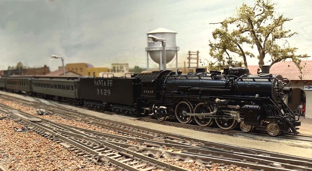

Here's the test train, and it's considered at least an operational success in DC.
I have to admit I'm not really happy with the paint.   Too black and too glossy, and the silver number fades out.  And after looking at a whole lot of 3400 Class photos, in service, the rods and wheels were anything but silver.   A couple were, but not typical.
And I also discovered that I need a smaller speaker if I have any hope of ever putting that speaker in the front of the tender wall, got one ordred.
But here's what I mean by appearance:    Jamco Pacific 3415:
Compared to the PRB model:
Rods maybe, and of course those chrome pilot wheels, but overall.... I far prefer the 3415 treatment and will likely repeat it.
