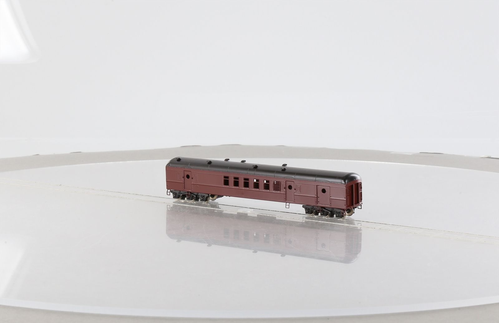

This set looks good but I believe this is an HO set.  The N scale brass set did not come with a B60b.  The Broadway Limited never carried a baggage car.  I will also note that the gold stripes look a bit too thick.  The five lower stripes were 1/4".

« Reply #21 on: August 13, 2026, 04:15:29 PM »
That looks like a B70 to me. But yeah, the BM70M RPO is the more correct head-end choice…

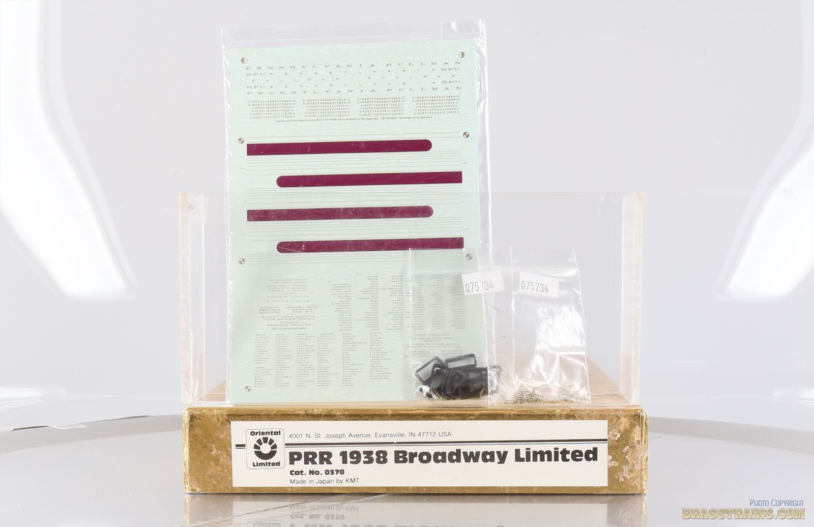

« Reply #22 on: August 13, 2026, 09:40:19 PM »
Yes, that is an HO set.
The only N scale FOM brass set I recall was from Oriental Ltd.
The cars were factory painted in a lighter Tuscan base color.
The darker Tuscan window band, as well as the gold/tan/buff striping/lettering, was furnished in the form of decals to be applied by the customer.
I remember when these were first released and opted not to buy one because of the decals.
