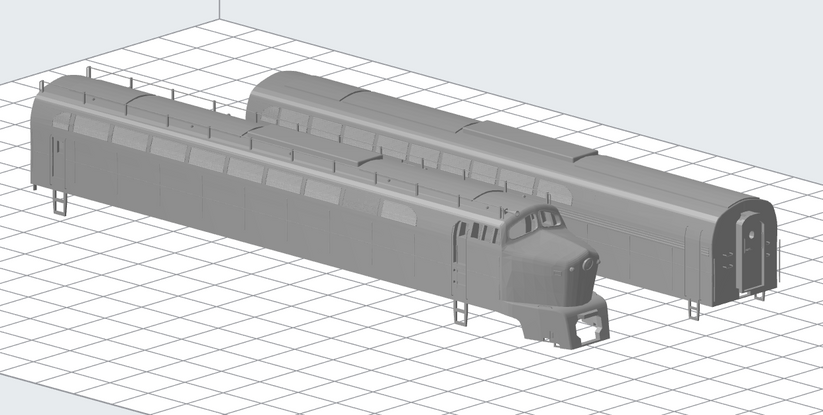

Well you just happen to be in luck
https://outoftheboxmodels.com/products/blw-dr-6-4-2000
(I am not plugging for OOTBM - they just happen to have the requested models)
He’s working on the side frames. I know they aren’t 100% correct but they are 95% correct.

Is it just me, or is the OOTBM nose short like the resin shells?

Looks that way to me.

Yes, the "Out Of The Box" 3D shell, definitely looks like the person designing the shell doesn't yet know, that the Passenger Sharks had a noticeably longer nose.  See these pictures for comparison below.
From my Pbase album:   https://pbase.com/atsf_arizona/baldwin_passenger_shark_foobie_in_n_scale
You can clearly see the difference.
Other photo from my album, showing the longer Passenger Shark nose:
vs. the Out of the Box drawing, you can see the nose looks short in his diagram:
If anyone knows the Out Of the Box author, pls pass this info to him, this would be something he could change in his 3D design.
P.S.   He does have the wheelbase in the ballpark, as the SD70ace wheelbase is 48 ft range, and the Baldwin Passenger Shark wheelbase is 46 ft 3 inches ( according to "Hosam":   http://www.hosam.com/blw/whb.html  ).
Of the various locomotive mechanisms that could be used, the SD70ace locomotive length is pretty close:
It is certainly true that almost nobody is going to know what a Baldwin Passenger Shark's true dimensions really are supposed to be, thus foobies like this fit the "good enough for 3 foot viewing distance" modeling rule.

The Out of The Box author can see all the info needed to modify his 3D printed shell, by seeing this online article:
https://jbritton.pennsyrr.com/index.php/tpm/393-passenger-shark-article
It has diagrams of the correct longer Baldwin Passenger Shark nose:
It'd be great to have a Baldwin Passenger Shark 3D shell with the correct nose contours:
You can see the freight RF-16 shark has the shorter nose:
And you can really see it here on these HO models:
I hope this helps.
