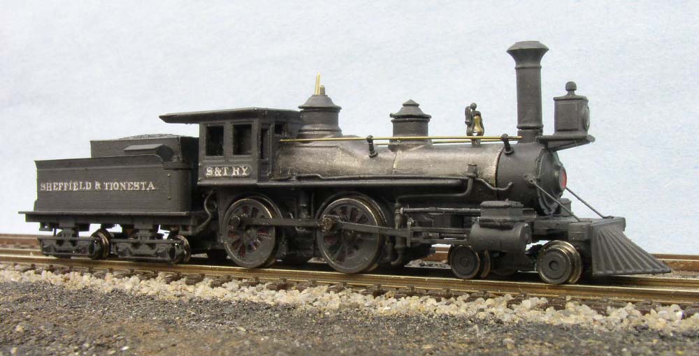

Not all boilers are black, either.
If you go back into the 1800's the 'top end' material was Russia Iron, which was a specialty metal with a lot of force-pounded graphite into it, and it could appear almost silver.   When you see a silver-looking boiler jacket on a model that's an attempt to simulate it, but it's a poor one.
https://en.wikipedia.org/wiki/Russia_iron
I've done Russia Iron by a successful experiment of Testors Steel and then applying Neolube on top of it and polishing it back out.  This 4-4-0 on the C&NW ended up on my local logging railroad as the 'hot' passenger engine.  But it still had that semi-reflective silver boiler jacket.
Prototype:  https://pixels.com/featured/steam-locomotive-no-605-of-the-chicago-and-north-western-ry-1899-california-views-archives-mr-pat-hathaway-archives.html
Same locomotive in service on the Sheffield & Tionesta, full of dents, mismatched pilot wheels, but still polished:
http://www.randgust.com/S&T4.jpg
Model (Atlas/Microace 4-4-0)
Link:  http://www.randgust.com/S&T404.jpg
