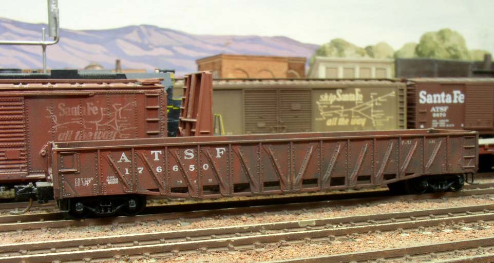

Whatever you try, it's still worth it.     Same carbody, before and after, on an MT 40', this one has the floor pushed up inside the carbody:
Link:  http://www.randgust.com/mtlower2.jpg

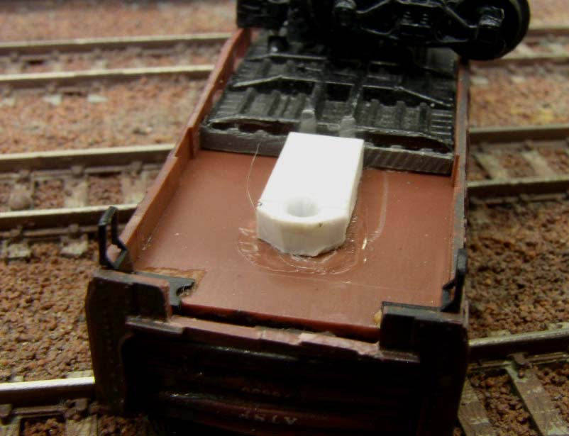

Just as worth it on gons and flats:   This with a full bolster replacement.
link:  http://www.randgust.com/MTdropgon2.jpg
And I'm not getting into the coupler height issues at all because I retained the original trucks.   I very much use magnetic uncoupling and truck mounts are still preferred for me on that keeping the coupler aligned and proper height.
so do you mill something off of the top of the floor, or modify the carbody? Picture of the bottom of the gon?
TIA

I have a reputation for 'just doing it' to see what will work, paying no attention to anybody, and this is another classic case....
Link:  http://www.randgust.com/MTdropgon1.jpg
Yeah, hacksaw off the original bolsters and put a styrene one in there....glue to the plastic car body on a flat or gon.  Heresy.
Another benefit, at least for me, is dropping the car height also makes the pizza-cutter flanges about invisible.    The current wheels work well for me but when I was doing this the low-profile wheels were a failure, stringlining off on a heavy train as soon as the flanges scuffed up.

« Reply #39 on: December 16, 2022, 09:40:24 PM »
Thanx, that is not what I was picturing. Picture worth 5000 words!
