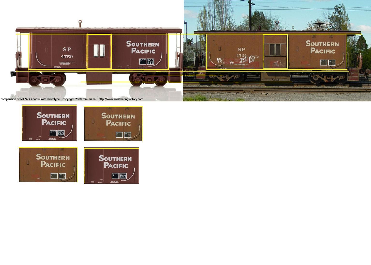

My recollection is that the MTL caboose is based on the last cabooses SP had built- after many railroads had already adopted the end-of-train-device.  I was under the impression it was accurate for what it was, but I'll take Bryan's word that "it is off."
It does seem an odd choice for a manufacturer that tends to worry a lot about how many road names they can plaster on something.
A couple years ago, I was just about to start on a bay window project- attempting to rehabilitate a 70s vintage Atlas or MP (or ?) to paint for Erie.  But I luckily procrastinated just long enough for Bluford to bring out their caboose in Erie paint.
https://www.therailwire.net/forum/index.php?topic=19396.0
Will show the difference between the two.  Why a SP prototype?  SP is a popular seller, the C50-5 thru 9 were produced at a minimum of 50 cars each. Like SW1500's ( I believe half or close too half of the SW1500 made were purchased by SP/SSW) SP Bay Window cabooses can be found on many short lines>
Albert in N

Yeah, the MTL model was immediately identified as too tall, even before Athearn released theres.  If you really want to work on it, you have some cutting to do.
  • Posts: 6447
  • Respect: +1427
Re: Improving the MTL Bay Window Caboose?
« Reply #11 on: May 23, 2022, 03:37:08 AM »
Yikes. That really shows how badly this is proportioned. What I find really strange is that all the vertical measurements seem to be off by the same ratio. One wonders if there was a mistake in scaling the 3d model before tooling the car. I just can't believe the metal steps of the underframe were screwed up at the same percentage as the plastic body.
