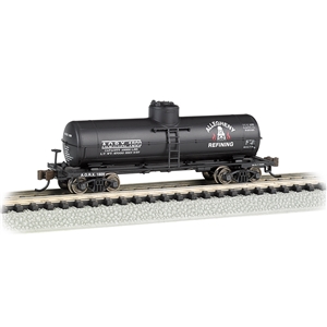

My side interest in PRR 1920's led to the oil boom era in PA, and my T-trak Trunkeyville module has a siding for loading tank cars, and my Jamison T-trak module has working oil jacks.
Prototypically, this was dead center in the middle of the Pennsylvania oil fields, so finding 'little' 8K-10K tank cars with interesting local refineries has been hit and miss - the "Wolfs Head Oil" in Oil City is dead on for the Intermountain car, I remember when that refinery was running.  Now cars are unobtanium even when I had a reserve.
I just came across this one in NOS in a hobby shop and bit, and then got to researching.   Would seem legit, looks legit....but it's Bachmann.
https://www.bachmann.co.uk/images/ocw/17861-9930-large.jpg
It's no longer in production.   Love the scheme and logo, but unless somebody can prove otherwise, I think what I have is a rather convincing looking foobie here.   I usually don't get bit with foobies.
AORX reporting marks - 1800 series - I don't think they existed in 1923 for the car date on the sill.   Anybody got a really old equipment register?
"Allegheny Refining".....   Well.... it did exist.   In Verona, PA, but in the 1950's.   The closest is "Allegany Refining" in Bolivar, NY in the 1920's, that seems real enough, was on the the Pittsburg & Shawmut, probably had tanks.   But not same spelling.
Then I found out that Bachmann has been putting this on their HO cars with a triple dome and the sound-producing HO tank farm...same logo.
So I think I have a foobie here.   But if anybody can prove me wrong, I'd love to see it.   I really like the car and that gusher logo is great fun.

The AORX mark does not appear in the July 1946 OROR. I seem to recall however seeing a photo of the car someplace. I would not have bought the car either if it were a total foob.

I found a listing for "AORX" that says is was "Athens food and refining company".
http://pwrr.org/rrm/rrma.html
AORX      ATHENS FOOD & REFINING CO., INC.
"Food and refining" seems an odd mix, but I assume they refined sugar, or refined vegetable oil.
Can't find a reference for Athens Food and Refining, per se.  A couple "Athens Foods" came up, along with a reference to Philadelphia, once known (maybe still is if you take a civics class in Philadelphia) as the "Athens of America."

That same reporting mark list does have an "Allegheny tank car company", but reporting marks were ATKX.  They built and leased tank cars.  This link has an ad from 1919

  • Posts: 3283
  • Respect: +3005
Re: Foobie or Not? Bachmann AORX tank
« Reply #6 on: August 23, 2021, 04:56:53 PM »
The neat logo is an oil derrick with a gusher on it.
So animal fats are out.    And the site down in Verona is most famous for being a superfund site now.
The Bachmann HO triple domes are a real obvious foobie, white car with the same logo and bright red colored domes.   The oil storage tank the same way.  https://shop.bachmanntrains.com/index.php?main_page=product_info&products_id=5992
That's a lot more painfully obvious.
But I'll have to admit, I'd read about an "Allegheny Refining" somewhere, well, yeah, but it was "Allegany".  Around here, you've got about four different spellings of the same word - The Allegheny River runs through Allegany, NY next to Allegany County, NY.

Allegheny Refining in Verona, PA did do some food additive "related" business - here's a bit from the 1961 Federal Register:
But, most online sources have that business starting in 1948.
Unless some real evidence emerges, I'd say the Bachmann cars are fantasy.
I like this reporting mark listing as the entries are actually dated, but Athens Food and Refining is also the only AORX listed (1950-54)
http://nakina.net/other/report/reporta.html

When you can fake out both the name and the reporting marks, that's a pretty fine foobie.
