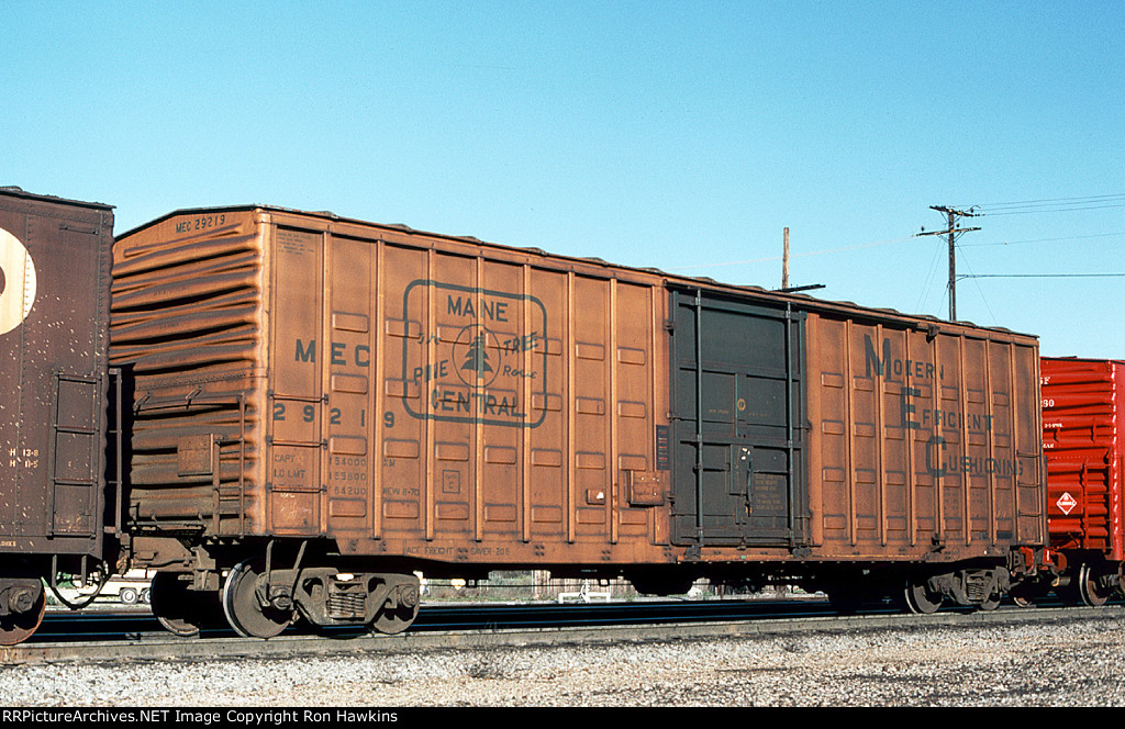

I have begun this project. Starting with the Atlas 50' Precision Design boxcar, I cut out the sides keeping the ends and roof. New sides were made from two layers of 0.020" styrene. The back one is a plain rectangle, the front one has a cut out for the plug door. 9' wide, 9'6" high. The plug door framing was built from 0.020" x 0.030" strip. Brass wire was used for the bars. The sill is 0.040" x 0.060" with the ends shaped to match the prototype. Need to add the lower door rail, then on to the other side...

This model has now made its way to the paintbooth, I'll photograph it once its dry. Then decals and weathering. The decals are from Highball Graphics and do two cars per set. Unfortunately the other car is different. From a decal perspective the biggest difference is that the logo is slightly larger and an outline, rather than solid green.
My thoughts are now turning to how to model this other class of boxcar. Built by ACF in 1970, they're perfect for my 1971 era. However, they have waffle sides. This makes them interesting to model, but harder to find a stand in. I think starting with an Atlas ACF boxcar and making new sides is, again, the best option. I'm not sure how big the waffles are though. Its a 9' door and a 50' boxcar, so that's approximately 2.5' per panel including the post. So are the waffles 2'x9"? Something like that I think, but I'm not sure. Thoughts?
The ACF X-post Precision Design may not be tall enough - note this is a Plate C car with slightly different ends (corrugation instead of rib at the top, also a small rib above it).
Depending on how many compromises you are willing to make, the FVM 7 post car might be another option to consider:
-The FVM car also has the top rib rather than corrugation, but I recall the height may be a bit closer.
-FVM car has the correct number of ribs, but the spacing appears to be different (shorter end panels on FVM vs what appears to be evenly-spaced panels on the prototype.   The door on the prototype also looks a bit smaller (possibly 9') and the FVM car would need the ACF sill added
-FVM has X-panel roof rather than diagonal panel

Just a side note, but the plug door from the MTL FMC 50' rib side boxcar is a good choice to replace the sliding door on the Atlas ACF precision design boxcar. I think it is a 10' door, but the difference between 10' in N and 9' is .075 inch.
This is an Atlas precision design car is added an MTL plug door to. I should have made sure it was more flush with the side of the car, but this was something of an experiment/learning experience. Still need to renumber it to the correct number series.
Not trying to dissuade you from scratchbuilding a 9' plug door, just wanted to propose an alternative.

I seem to have forgotten that there are two versions of the Atlas Precision Design boxcar. There is the (mostly) smooth side version that I used for the other car, but there is also a rid side version. It has six ribs either side of the door and a 10' (or maybe even 11') sliding door. If I were to remove the door and fit the correct 9' plug door, there would be space for the missing ribs. Not sure about the ends though, it has a rectangular top stiffener, where as the prototype has normal pointy ones.

Honestly, I probably wouldn't let the ends bother me, but the wrong number of ribs would make me nuts.  :D
ACF boxcars drive me crazy. Missouri Pacific exterior post 50' boxcars were almost entirely built by ACF and expect for 500 that are plate B versions of the Railbox ACF boxcar Atlas did in the trainman line, they are all like this- 7 post sides, or non terminating ends and plug doors on the 6 post body, or 8+8 plug/sliding door combos. Not bad enough to totally throw your hands up, but bad enough to slow you down trying to figure out the best way to attack the problem...
