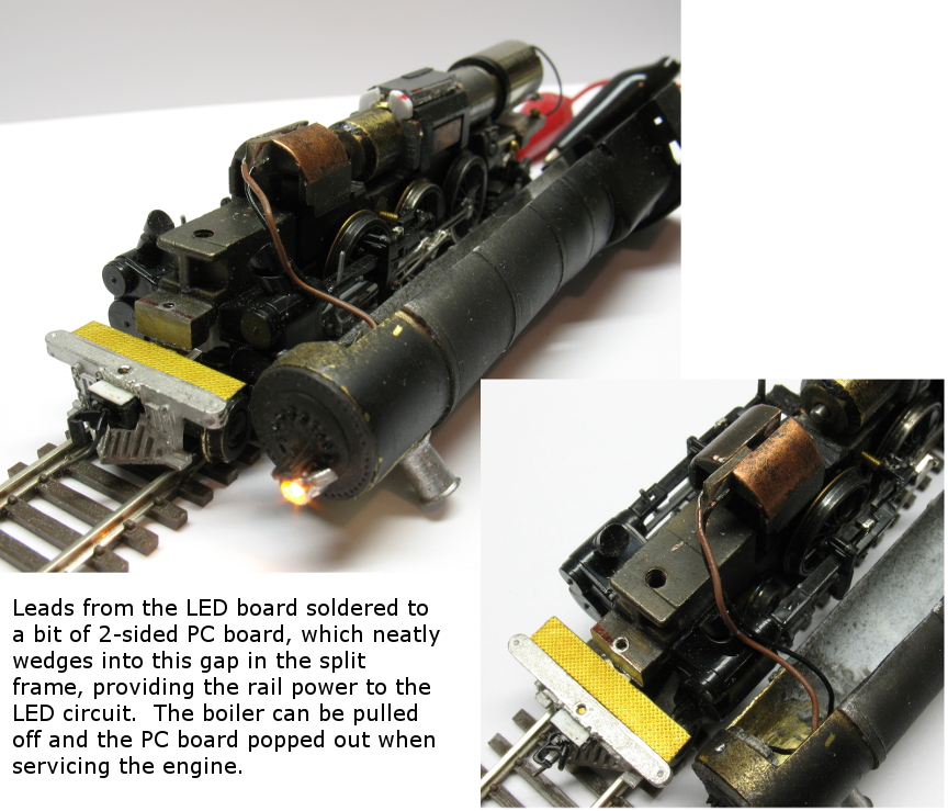

How about soldering wires to the truck tabs and the other ends to pcb wedged between the frame halves?
As long as the pcb was double sided or two single sided each end. Thickness such that it will clamp down by the frame screws/nuts but not too wide to upset the frame alignment.
You have to slack the frame screws to get the trucks out and this way the wires would drop out too.
Do drilling and tapping either.
YES.  This is a great approach.  I even used this idea in a steam loco project I did some time ago.
Neat, solid, and yes, it means you can just loosen the frame screws to remove the trucks and the wiring without any tapping or
unscrewing.  Just experiment with pieces of styrene shim to get a fix on the thickness.  Two-sided PC board is commonly available in 1/16" and 1/32" thicknesses.   If 1/16" is too thick, and 1/32" is too thin, just solder a little bit of thin strip brass to one face of some 1/32" to thicken it up a little.  Then you can file it until you get just the thickness you need so that it fits firmly between the frames without messing up the frame width.
