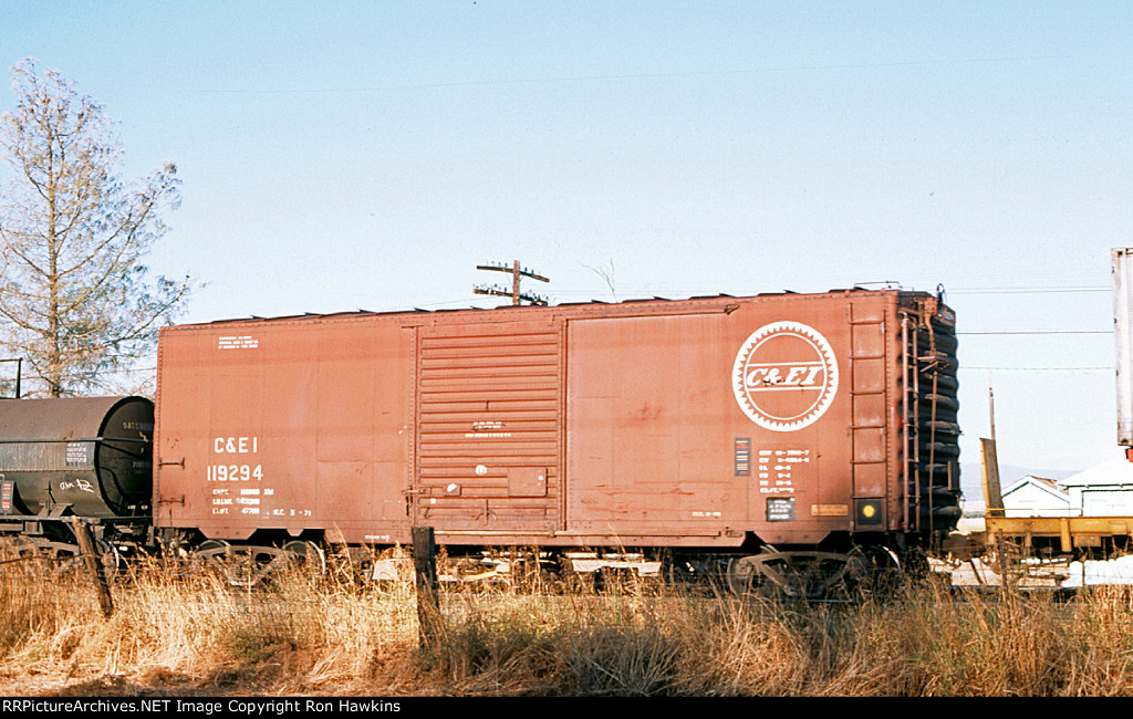

Is this what you're trying to model?
http://www.rrpicturearchives.net/showPicture.aspx?id=3423216
Posts: 10599
+1773
Re: C&EI boxcar numbers question
Reply #6 on:
September 08, 2019, 02:08:27 AM »
No, mine has the older large initials and spelled-out name. It does have the MP-style numbers, though, like the one you show. It looks like the same series, though.
