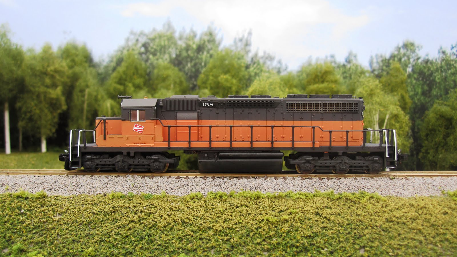

Hi all,
Have any of the forum members had any success in milling Kato sd40-2 mechanism frames for a smaller fuel tank .
Like the Milwaukee road had on their sd40-2s .
Yours Alex

I have done over a dozen of them. Somewhere I have photos of what I did. Or, You can take the easy way out and contact Intermountain for their short tanks, which would be appropriate for Milw. Soo, as well as SD38-2s.

It’s not too tough. You just have to be careful how much frame material you remove. Cut the end of the plastic tank off and shorten to your liking.
Karl

Thank you all for replying, and jpwisc, that locomotive is beautiful.
