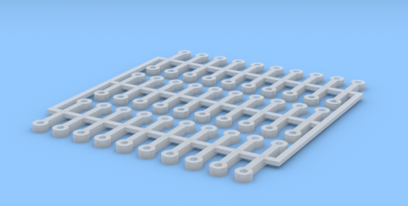

The new draw bars are in and they appear successful.  I'm going to send a bunch to Mike (C855B) for some testing to see what the FXD material can handle.
Here's the link if you're interested.
https://www.shapeways.com/product/QHZVTWDAC/drawbar-for-atlas-tsc-ore-car-adapter
Tests so far are 100% positive. The first thought crossing my mind when I opened the envelope was "Stout!". I don't think there's anything to worry about with the strength of the FXD material. I haven't put the 50-car test train behind them yet, but I have zero concerns. If there is a handling issue I foresee, it is going to be mishandling with a twisting motion that might pop a press-fit lid off a coupler box. A roll-over derailment might also do this, especially in a train with TSC since they're so tight and will dump the train long before uncoupling.
First test set was four cars with drawbars coupled to five with TSC. Everything smooth as silk, pulled and pushed through crossovers and pretty much everywhere on the layout. No problems through #7 turnouts. (I've discovered Atlas C55 #7 switches have poor transition into the diverging route - I'll get wheel lift coupling the ore cars, quite short at 27',  to 60' cars with TSC.)
Further testing will be with two-car sets unless Jason has a special request for something else. Four cars operated without issue... except putting them on the track with FVM narrow wheelsets. Getting all 32 wheels... count 'em!... on the rails with a hard-connected set reminded me of that guy on the Ed Sullivan Show who balanced those spinning plates on sticks. Once on the track, no problem, but you know you're going to put 'em on the ground sooner or later.
