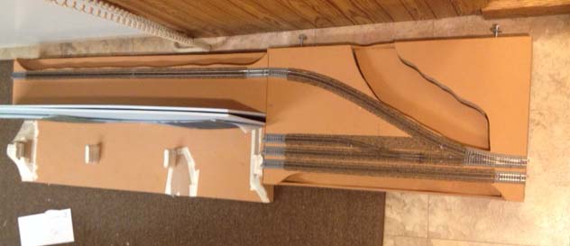

OK, well, for my own interests, I started out with a model I really wanted to do - West Hickory Bridge.  That's single track.
I'd already built a T-trak module (triple) of the junction at West Hickory.   Original intent was to come off the FRONT, for my own uses, with a bridge module.
When I got into it, I decided that as long as I was making a long, single-track bridge module, I may as well make it the same T-trak triple dimensions for length, connectors, etc.   I settled on an 8-inch width plus skyboard, with the track centered.  There's a long construction thread on this already.
I also needed another module on the T-trak West Hickory Junction module to close the interchange track, made a double.   Then made a REAL discovery.   On a double, I could divert the inner main to swing BEHIND and end up completely behind the skyboard on the single-track bridge.   It's more or less a 'splitter' pushing the inner track behind a single-track module in the front.....
I built a second single-track module triple to get across, and then a second double splitter going the other way.     So, in a way, what I've stumbled on is a way to take T-trak an convert to a single-track mode on both ends.  And it all fits in the T-trak footprint.   It uses a Kato #4 turnout and stays consistent with 19" radius curves.
Here's an overhead view of the bridge module (just the piers visible, the triple module BEHIND it for the second single track, and the splitter module on one end.
I'll have five of these modules at Altoona in various stages of construction.    I'm not sure if I've developed an eagle or a dodo bird here, but I've got a very flexible collection of modules now and ways to get in and out of single-track mode.
Also, FWIW, the only place I use Kato connectors is on the edges - I convert everything in the middle to Peco C55 wherever I can.  That's really evident on the West Hickory module that is weathered and ballasted.
What's attracted me to T-trak is both the geometry and the portability - I really can't handle a 4' module.   A 36" T-trak is a lot more manageable.   I have neither a bigger truck or a trailer to haul around anything bigger.   And, the number of accurate modules that have main-line triple track are pretty limited, even on what I'm doing with 2-track T-track is generally a main and a 'siding' in cinders.
The geometry of West Hickory is set up to be a conventional triple, connect with my 'splitter', connect with my bridge to go out at a 90-degree angle to single grack, or be a splitter on its own to the rear track.    And this was also a real place with this geometry copied from the 1917 valuation map.

I'm a proponent of T-Trak, but there are some considerations. Unless you make longer (2x, 3x, etc.) modules, you are pretty much limited to a straight main line. Because the modules sit on tabletops, that too constrains the layout shape and design. Another is that the scenery is pretty much behind the track(s), with only a narrow foreground.
My understanding is that the general "standard" for single-track T-Trak is to use the location of the front track (of the 2) for a single track stretch.

T-TRAK is "flexible" by stretching the perceived limits, like Randgust. (His Hickory Creek modules are awesome in person!)

Like Randgust, I use Kato connectors on the ends and flex track "in the middle" on most of my modules.
