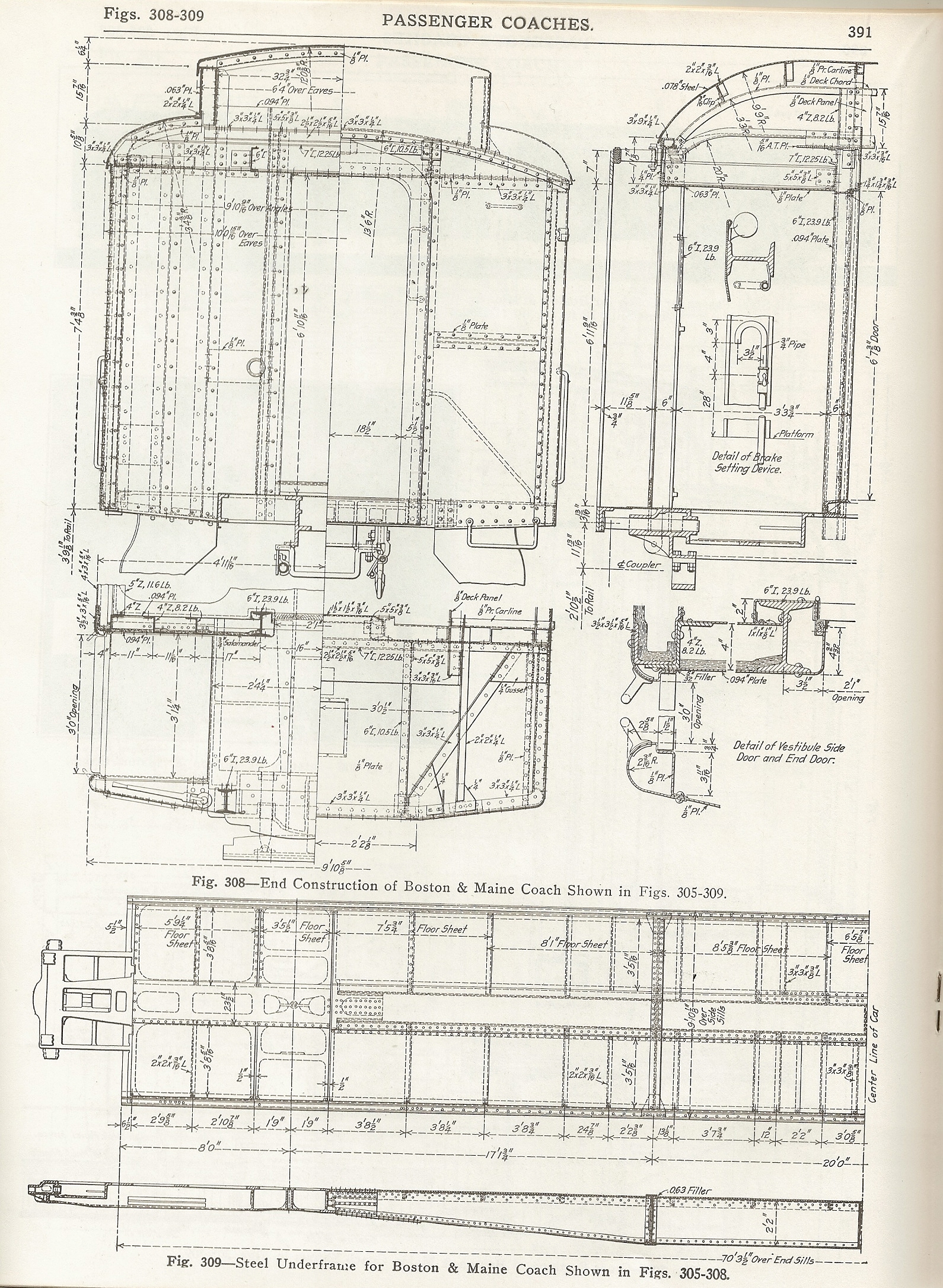

Not sure if this will work for you, but I did find this B&M coach that was built by Pullman.
There's are views of the end construction too if you'd want that.
I would, when you get a chance.  Thanks.

« Reply #6 on: August 14, 2017, 01:01:41 AM »

« Reply #7 on: August 14, 2017, 01:32:19 AM »
Perfect, thanks.
