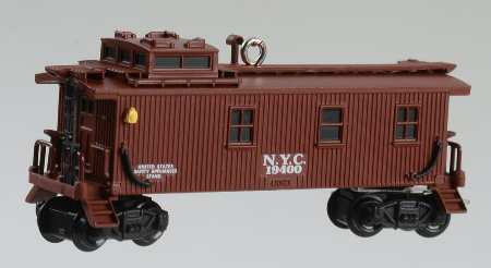

I've been trying to kit bash a New York Central 19000 series caboose from an Athearn three window wooden one. So far it's taken me two cabooses to shrink the cupola to the right size, and now the evergreen plastic for the side walk ways melts into the beams when I apply plastic weld.  :facepalm:
Lionel made an ornament based on the NYC caboose, but I don't know if the measurements are OK for a N scale model:
That's a sharp idea! :) If it's close to scale, I'll have to make a resin copy of it, since the windows look to be filled in. But after that I could take the resin copy and place it on the Athearn frame.

The Hallmark caboose seems pretty close. Just compared one to a MT caboose...its a bit wider and taller and quite a bit longer. I'd don't know how a NYC caboose compares to a SP C-30 caboose in size but it looks like it could work.
Peter

IIRC the Hallmark NYC caboose is fairly oversized for N.
The RPO that was part of the General set and the SP standard Lionel caboose are very close to N.
