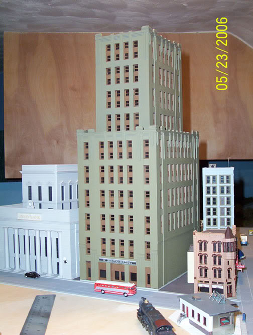

Well.. okay, I dusted off some old pictures of my PRR themed layout from years ago, when I was trying to work a city scene into the mix.
The photos ain't the best, and holy cow, there's no way I can compare to what Roger does.  But here they are.
First, my rendition of Roger Holmes' "Scale Changed Skyscraper".  He did a piece in Railroad Model Craftsman a number of years back on how to convert a Bachmann HO scale "city scenes" skyscraper to N Scale by cutting the windows in half and flipping the halves around.
I think it was a brilliant idea.  At the time, you could pick those kits up really cheap because they apparently flopped and Bachmann was stuck with a boatload of them that were being dumped at train shows for under $25.

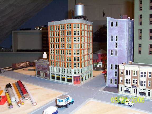

One other one... this was inspired by the famous "Flatiron Building".  It is two DPM kits bashed together to get extra height.
I boiled the resin sides briefly in hot water and found I could bend them over a pipe.  It was dicey work.  If you go to far, you will easily warp and deform the window openings (and you can see some of that in this photo, but in real life, it was pretty well disguised).
I just wanted one of those rounded-corner off-shaped buildings to fit non-90-degree corners because I think they add so much visual interest to a city scene.

Max-- That really blows me away that someone actually did the Bachmann conversion that I wrote up for RMC and that it's a fellow Railwire member to boot.
Your Flatiron Building is a great idea.  I'm sure that it took nerves of iron (pun intended) to bend that corner so smoothly over that many floors.  Very impressive!
Roger, you are too modest.  Your structure work is excellent, and I'm sure I'm not the only one who learned from what you wrote.
That "Flatiron" building is 3 Hilltowne Hotel kits.  If I recall correctly, I bent some regular wall sections one at a time and then stacked them up and glued them together.  I think I tried doing it as one tall piece already glued up, but the boiling water made the glue let go.
