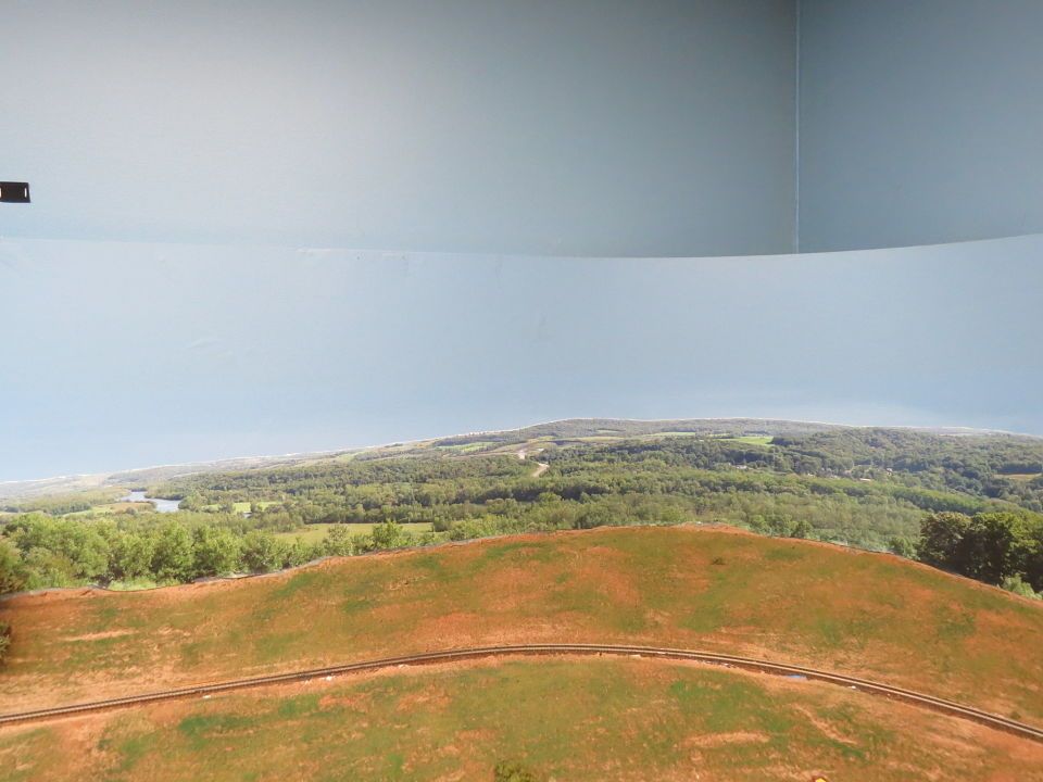

I too have been looking at a variety of options for backdrops.  I need over 70 feet of backdrops and when I priced them out commercially the cost was going to be around $1400 US or almost $2000 Can. from any of the commercial suppliers.  I had been looking at the backdrops from LARC Products and they offer a 6 volume set of CD's with over 900 backdrops and 100's of buildings that you can print yourself for $75.  In looking at videos on YouTube of how others had done it, I came across one modeller who suggested full page labels as an option.  (unfortunately I cannot find the video a second time, so I don't know who to credit with the idea).  I decided it was worth a try since the full page labels would already be adhesive and at one page size, relatively easy to work with individually.  The key to this approach would be taking real care with the seams.  The photos below show an area which is under construction and which was my test bed for this approach.  I think they came out pretty good and the whole 70 feet of backdrops is going to cost me less than $200.  I got them commercially printed on a laser printer with a matte finish.

Oops, haven't posted photos in awhile and I obviously messed up, trying again.

Here are the other two
