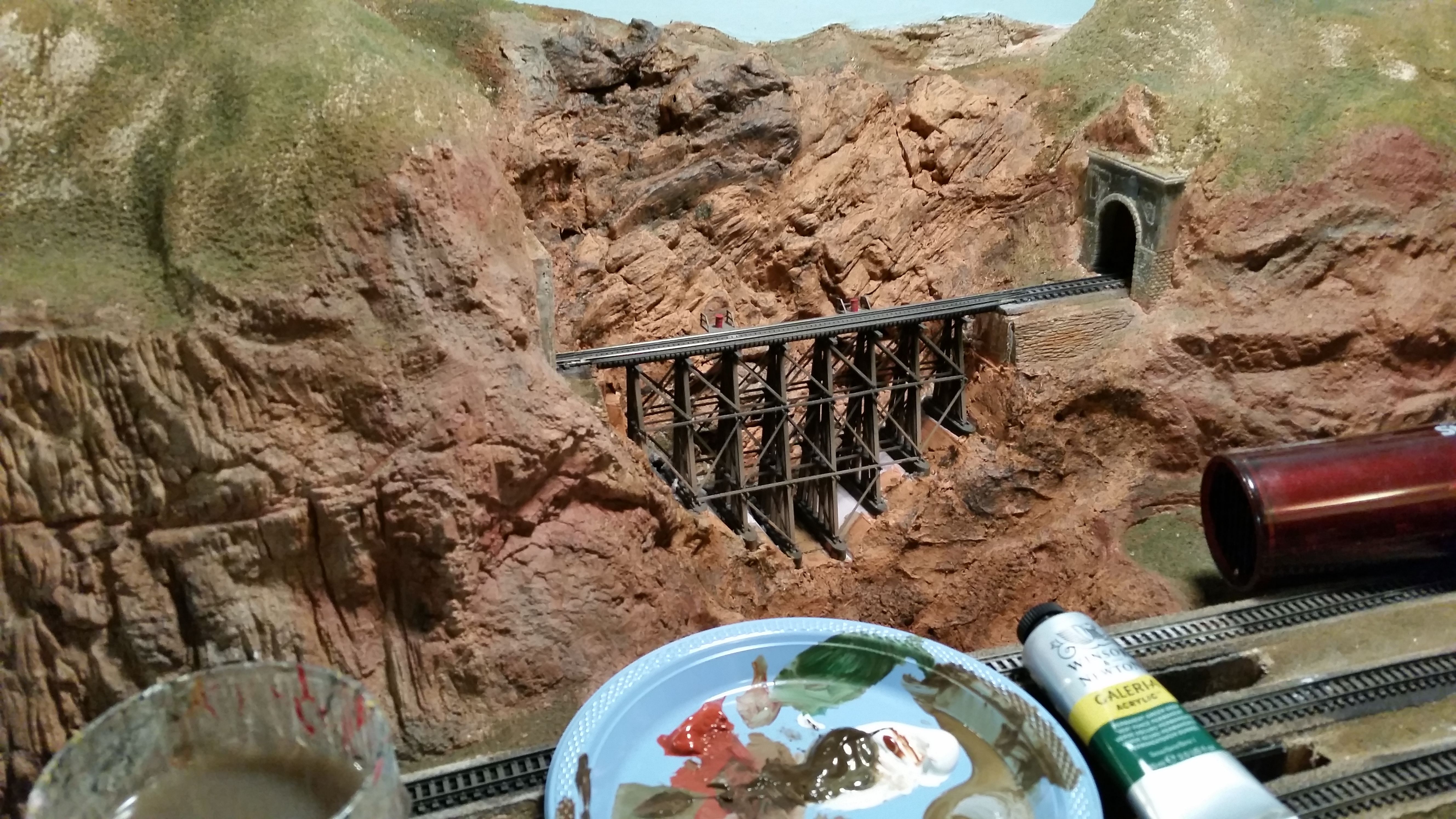

I' am sure I want to reply. The work continues on the Branchline Bridge on Nate Goodman's Layout. First a couple of old photos to refresh our memories. Then the paint work Bob Gilmore using artists acrylic paints to paint over the base color and blend the colors in to the rest of the original layout colors in the scene. A hair dryer was used to blow dry the washes of paint. Finally "Tada", the finished scene, colors look like the original. Total time required to cover the base coat about 45 minutes. Nate Goodman (Nato).
Photo (1) To Refresh Our Memory...Noch foam rock face cut to fit hole in plaster/cheesecloth cut to clear trestle:
Photo (2) To Refresh our Memory...Rockface and Styrofoam blended into existing plaster rock work using Celluclay:
Photo (3) Blended Noch Rock face with flat latex basecoat:
Photo (4) Bob Gilmore (robert3985) Applying Various Washes with His "Artist's Face" on:
Photo (5) Washes of Lamp Black & Burnt Umber Being Applied Into the Rock Cracks:
Photo (6) Waiting for Washes to Dry, Noting They Become Lighter as They Dry:
Photos (7 thru 11) Finished Rockwork:
Photo (8 ):
Photo (9):
Photo (10):
Photo (11):
