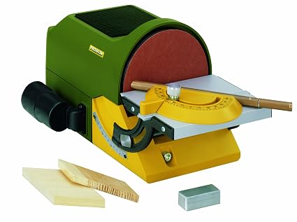

Re: How To Get Decent Mitered Corners
« Reply #2 on: May 08, 2019, 06:21:46 PM »
FWIW, I use one of these...
