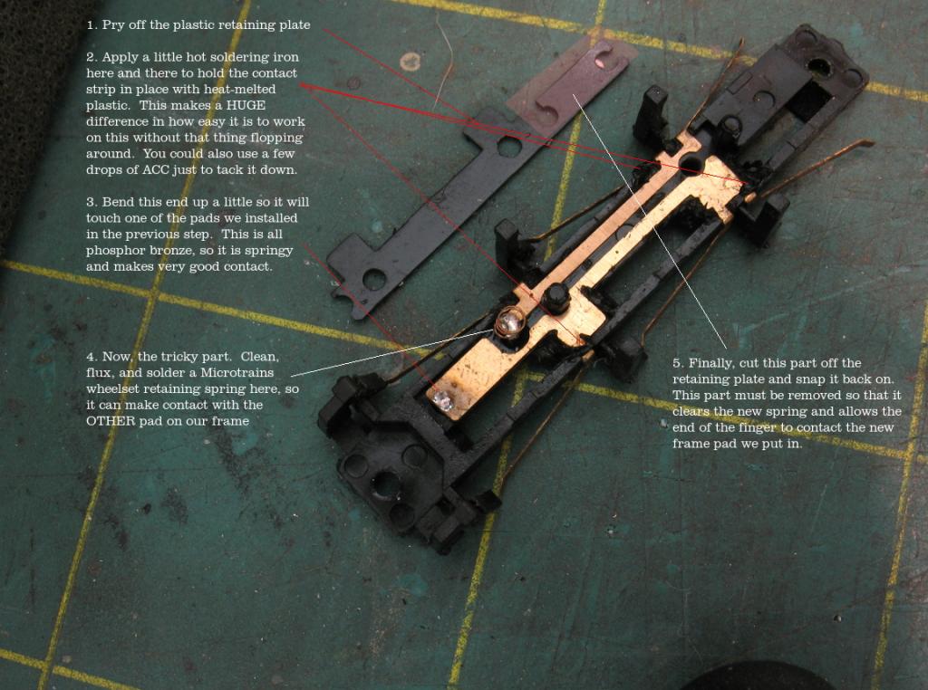

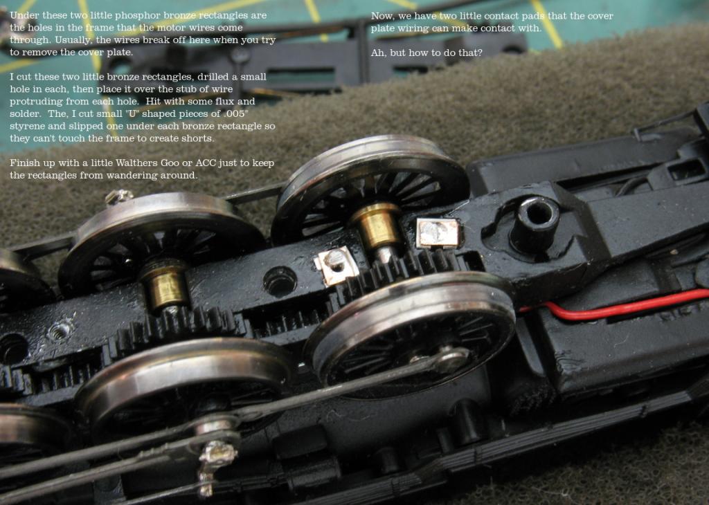

In the process of fixing one of these up for someone, I hit upon a good way to solve the problem of the annoying Model Power cover plate, it's mangled wiper strips, and those darn wires that notoriously break off when you remove the plate.
The idea is install two little phosphor bronze rectangular contact pads, soldered to the stubs of the wires that stick out through the bottom of the frame (where they usually break off).   Then, do a little bending and add a bronze spring to the contact strip in the cover plate.  After that, the cover plate can be removed at will, with no wires attached to it!
Also, after this mod, since there are no wires in the way, I found it very easy to get the plate off an on, and slip those wheel wipers right in behind the wheels as I would re-install it, with no hassle.
This did take some delicate soldering, but it's not too awful.  A few hours' work.
To begin:
Now, the contacts inside the cover plate itself:
So now, when you put the cover back on, the little spring touches one of our new frame pads, and the bent part of the strip contacts the other, completing the circuit.  Everything is springy phosphor bronze, and none of these are moving parts, so the contact is quite reliable.

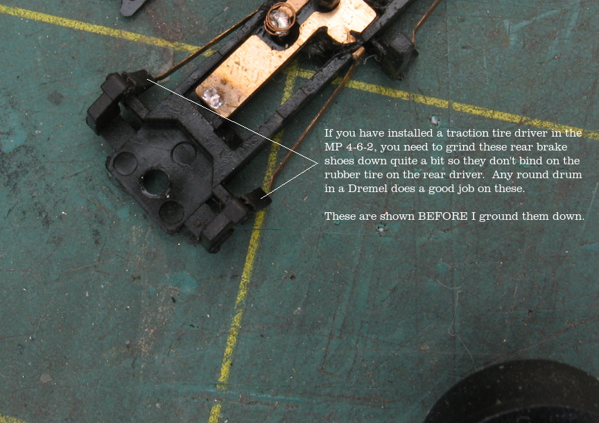

If you add a traction tire driver, here's something to be wary of:
