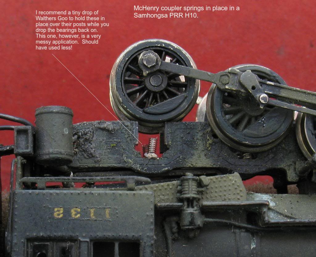

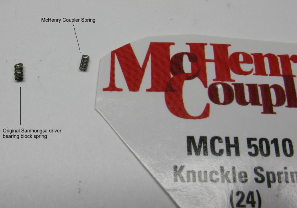

Here ya go:
$6 for 24 springs.
Here they are installed in a Key PRR H10
I can't say whether they work better or worse.  The engine ran good before this, and it runs good now.
They fit in really nice, and they definitely have a softer feel than the originals.  As you can see, the original springs are
not all that well made/wound.  Also, with a pair of tweezers, I can lift this driver set a touch without lifting the engine,
which I cannot do with the other drivers, so I think these are an improvement.   But like I said, I don't have any scientific evidence to back that up.  It runs good either way.

  • Posts: 6499
Re: Repairs for Samhongsa steam- those pesky bearing springs
« Reply #9 on: May 30, 2014, 02:25:30 AM »
It sits perfect, from what I can see.
And yes, when you put them in, you will immediately feel that they are a little softer and they let the drivers
lift a little easier.
Bear in mind, I only replaced the back two on this engine.
But then, that's what people are likely to do, replace just the missing springs, not all of them.
I think you should at least replace them in pairs so the springs on a single axle are the same.
Before I posted this, I ordered another pack of 24, because I figured you guys would scour the internet and
clean them all our wherever they may be.   But it doesn't look like they are an "unavailable" item, so they
should be relatively easy to find.  eBay had them, and the hobby shops like Klein's had them.
I had them because I noticed a pack of these in a "scraps" bin at a train show and thought, "Wow, those are some
pretty darn small springs, and they are not the super-light micro-trains springs.  I bet I can use them someday."
