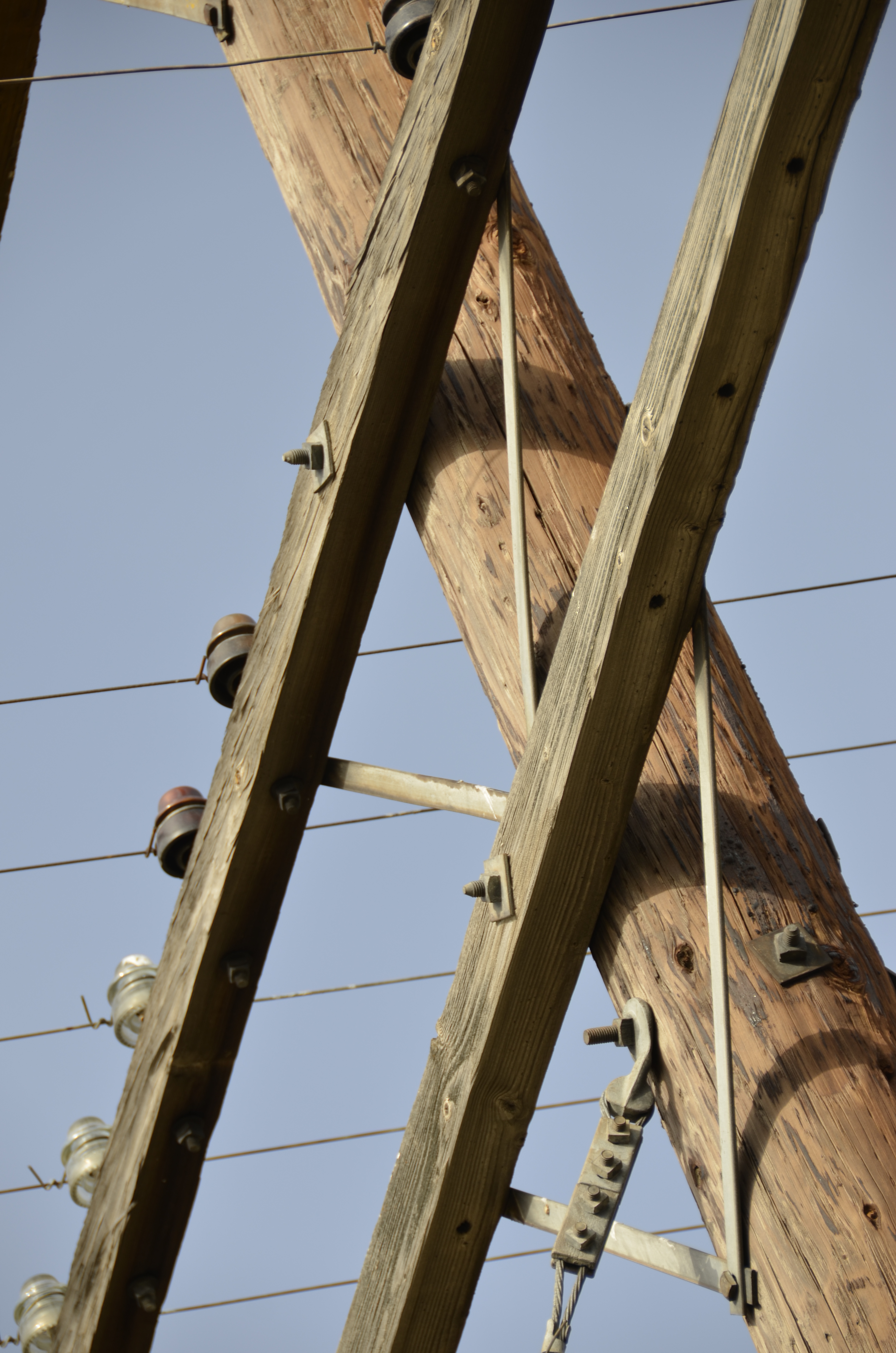

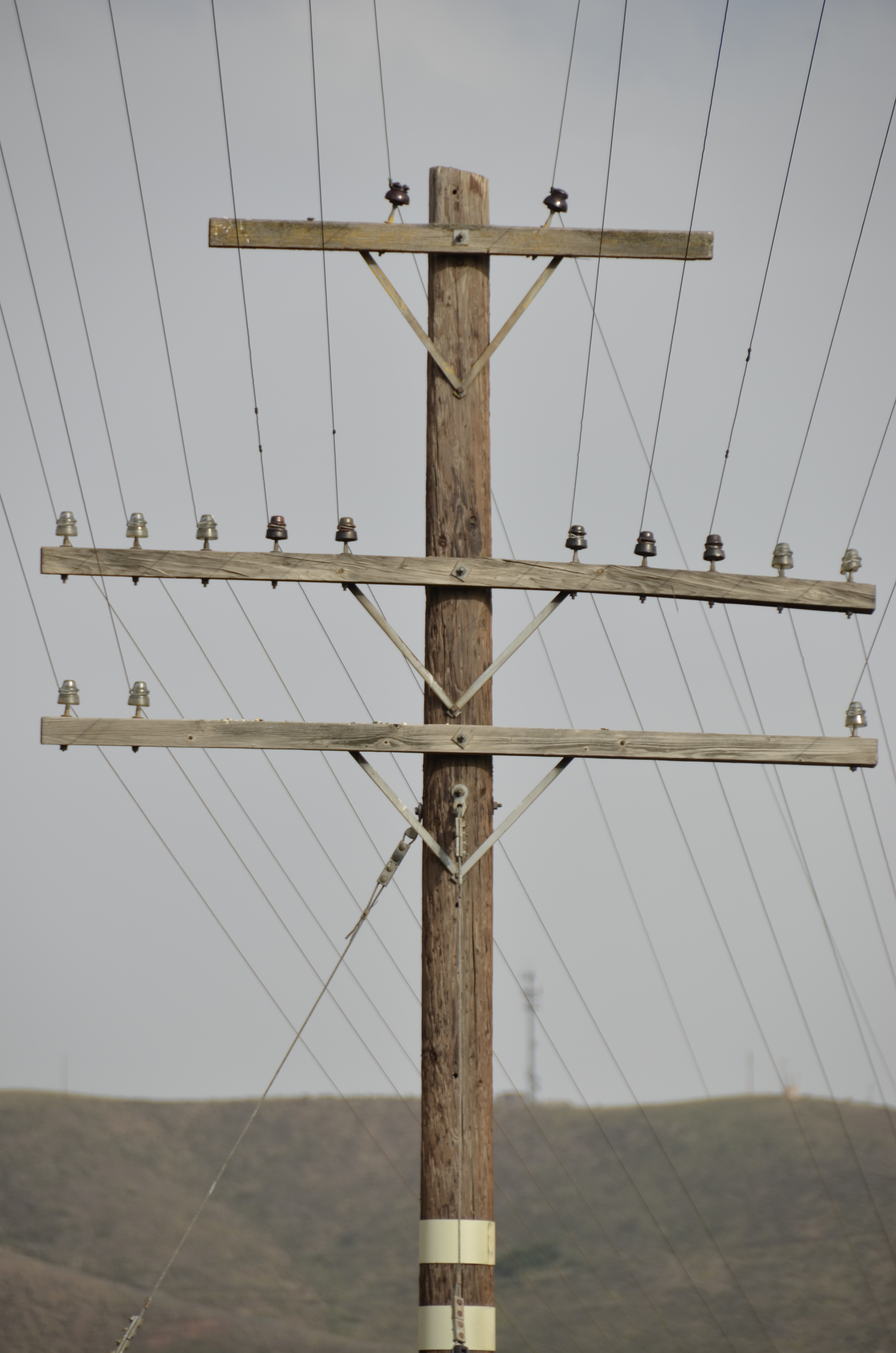

Here are a couple of photos of UP poles alongside the Wasatch Grade mainline between Weber and Echo Canyons with some good closeups of the color of the aged wood:
One more:
Hope that helps to choose a couple of colors to paint the poles and crossarms.

Bob,
great pics!...that's the color I'm trying to replicate...a driftwood color...very non-descript...grey-tan...
I'm really loving these poles...the options they allow; with some trimming of the crossarms, almost any combination is possible

Even with their limitations, I have to admit they look better than anything else out there...yet   :)
Make sure you post some photos of yours painted & weathered.  On the poles themselves, prototypically the crossarms were mounted on different sides of the poles every other pole and the tops were cut at an angle to encourage drainage, and it also varied just the opposite way every other pole.
I see the poles are available both as "poles" and as just crossarms.  As opposed to plastic or metal poles, I've found that wooden swab sticks I buy at my local pharmacy look much better than plastic.  I haven't had any experience with metal.
Although the following technique works great for wooden poles, you might try scraping the metal poles, which would add some needed "grain".  The staining is only valid for wood.
I scrape my wood swab sticks with a fine toothed Zona saw blade, then swipe it a few times with a fine steel welder's brush to get rid of the "fuzz' the scraping produces.  This makes very convincing "grain" in the swab sticks.
I used to use Floquil "driftwood" stain, but...it's gone now.  I'm sure you could find a good selection of wood stains at The Home Depot or Lowe's that would probably work just as well.  I'd let it sit for a minute or four, then wipe it off with a soft cloth or paper towel, not applying much pressure, which allows stain to collect in the "grain", emphasizing it but lightening the high spots, so you'd be starting with a stain color that you'd think would be darker than what you want.  After you wipe it off the high spots, it's lighter and hopefully, the right "tone".
Also, you can see from the photos that the crossarms are a different color than the poles.  The poles I've photographed are a slightly reddish color, but the crossarms are more tannish-gray.
On newer poles, you can see a distinct "creosote" portion of the poles near the bottom.  I'm assuming the poles would have creosote applied to the portion of them that would be buried.  This fades after decades of being out in the weather.
Your telegraph poles may vary.  :)
