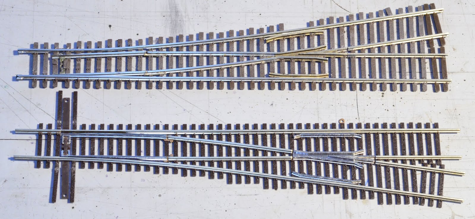

Here's a photo comparing an ME #6 with an Atlas 55 #7.  They're almost the same length:
My apologies about the beat-up condition of the ME turnout.  It's been salvaged off of a friends old module.
I'm happy that I didn't go with Atlas 55 turnouts and just kept plugging away, making my own.
