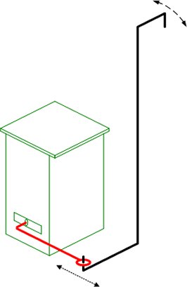

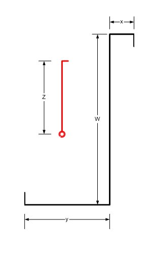

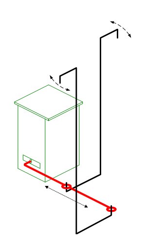

s40er
Re: Tortoise and Peco turnouts
« Reply #22 on: December 09, 2013, 07:31:15 PM »
Here's how I connected my Tortoises to my Peco's without removing the spring at all.   This gives the Tortoise a lot more torque, and made it fairly easy to have 1 Tortoise through crossovers pretty easily.
rsn48
  • Posts: 360
« Reply #23 on: December 09, 2013, 09:32:27 PM »
First about the Peco spring, some turnouts the spring isn't accessible at all.
What size wire do you use for the modification you use, with the tortoise wire moving the other vertical wire, what size is the vertical wire?
Hind sight is always better than foresight, except for lost opportunity costs.
The method shown by s40er might be needed when the scenery base is rather thick.  But if it is just plywood and roadbed, the standard installation (using thicker wire with the built-in fulcrum) works perfectly well.
All the switch machines in this photo thrown Peco switches with the spring still installed. But the standard throw wire has been replaced with a thicker music wire. I don't remember the thickness - I'll have to measure it next time I'm operating that layout.  I think  it is 0.032".
BTW, the only switch machine with the mechanism facing the viewer is not a standard installation. Due to space constraints, it had to be offset from the throw bar. It throws the turnout using an extra linkage inside a brass tube hot-glued to the bottom of the layout.  But the other machines hust use straight wire going up to the throwbar.
