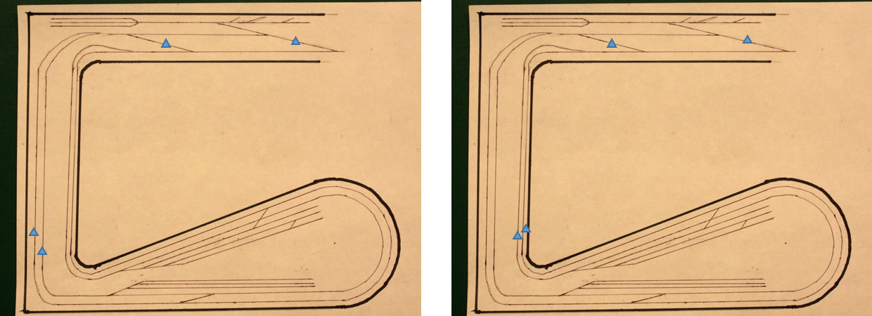

The alternatives Pete provided will work, but here are some other options you could consider, with gaps shown by colored triangles.
Regards,
Paul

In the image below, ignoring the small yard at the top, put a double gap between the two turnouts that face away from each other -- at the end of the double track running down the left wall and the crossover immediately to its right.  Following the double track down the left wall, double-gap each track just before the turnouts for the yard and the crossover immediately below it.
If the image is anywhere near scale and the mainline is 39 feet, this should give you a reversing section about 12-13 feet, more than adequate for 8-foot trains.  It also keeps the reversing section simple enough that you're not likely to have enough trains in the reversing section to overload the capacity of any reverser you select.
By the way, I'm sold on the PSX-AR sold by Tony's.  I use the PSX-ARFB, because the feedback output closes a switch, which can trigger an input to a DS64, which feeds JMRI via Loconet to show the block is occupied.  This eliminates need for a block detector.  But that is digressing.
Keep the reversing section simple!
Bill B

Bill, I'm thinking the reversing loop would be lovely and long if I went from the turnout you indicated (by the way all my track and turn outs are double gapped and their own block electrically) and the turnout just below it.  This way I don't have to worry about train lengths and could have four trains in the reversing section if I wanted.  Those long three tracks at the bottom are actually longer than what I have indicated, originally slated for passenger trains, re-thinking that but still would use at least one track for passenger.
The inner loop is arrival/departure for the series of small yards.  While one train is continuous running from lower level to top level (another reversing loop) while I switched by myself.  So two turnouts in the deck you can see will be auto-throw, in the process of installing that.  Probably won't be done until after Xmas.

The only caution I'd bring up with this plan is the number of trains in the reversing section could get quite demanding amperage wise, especially if there are a lot of passenger trains with lights.  Check the amperage limits on your chosen reversing device.  That's why I suggested the double track down the left side from turnout to the turnouts for the yard and the one directly below the yard, as there isn't likely to be more than one or two trains on each track, and then not for long.
If the reversing section includes both yards, you need to account for the current draw of all the trains in the yards as well as passing by on the double track.  Remember that locos with decoders still draw current, even if parked.  Ditto passenger cars with glowing lights, or with lights turned off by decoders.  If the cars have reed switches turned off by magnetic wand or switch, they don't count.
Otherwise, reversing the whole lower section from the upper turnout all the way to the one just below it would work fine.  Electrically there's no reason it wouldn't as long as you remain within load limits.
