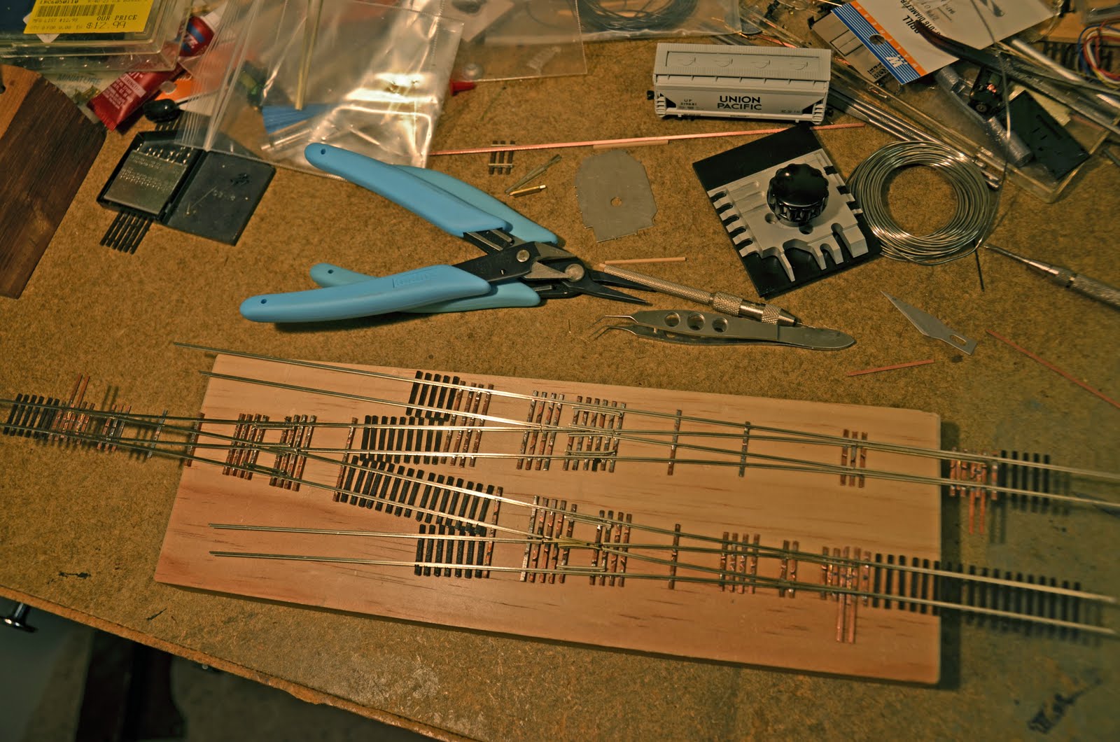

Hey "Chris333" (if that really is your name) :) ,
I hand-lay all of my turnouts and all of my code 40 track on PCB ties.  I've been doing it for 30+ years now and I've built over a thousand turnouts in N and HO scale (mostly N).  I've used all sorts of solder, flux and heating instruments and about 20 years ago I was introduced to both solder and flux that a fellow making brass N scale catenary was using to mass-produce his models.  The flux revolutionized my soldering and I haven't looked back.
I also use 96/4 Tin/Silver solder bought at the same site as the flux.  I know people will poo-poo my being so adamant about what flux and solder to use when building track, but I guarantee you, you will find this combination is THE VERY BEST you've ever used.
The solder is available here: http://www.ccis.com/home/hn/page5.html
Superior No. 30 Supersafe Soldering Flux (gel & liquid, I use gel) is available here: http://www.ccis.com/home/hn/page2.html
I use two heating instrument for my turnout making, my old, simple 40 watt Realistic wedge-tipped iron, and my American Beauty 250 watt resistance soldering station.
However, I've built hundreds of turnouts without the resistance soldering station, but it sure speed things up and makes my construction (on simply paper templates) much more accurate since I can position, hold and solder simultaneously with one hand.
This solder has no core (is solid) and to apply it with more control, I smash it flat with a pair of smooth flat-nosed pliers, split it down the middle so it's got a two tined "fork" on the end, then use each little solder tine to solder with.  Works well for me.
I have been completely satisfied with both the ease and durability of this combination for both trackwork and building brass and nickel-silver models, although sometimes I use a jeweler's Oxyacetylene torch and solders that melt at different temps...but not so much since I bought my resistance soldering station.
Here's some on-the-bench turnouts I built a while back as entrance turnouts for my Emory Center Siding on one of my layout sections with my solder in the pic:
Keep soldering!
