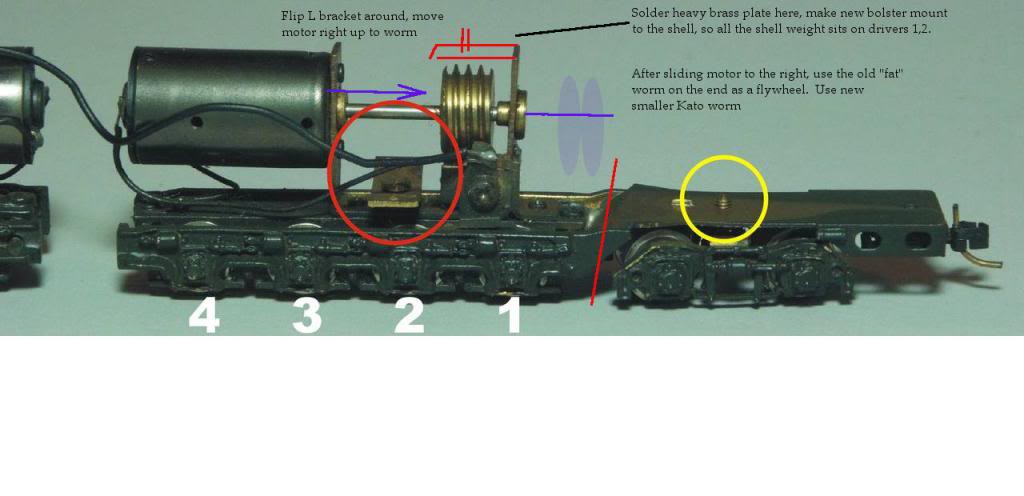

If it were me, I'd think about putting a nice fat flywheel on the motor shaft past the worm. (Much tinkering required, I can tell, but may be worth it.) This could help balance the weight distribution, and improve slow speed performance as well.
I'd also cut a hole in the bottom of the shell to clear that pilot screw...

What if you were to attatch a bent brass strip directly to the sides of the gear tower in such a way that it cleared the worm (think block letter T without the bottom):
________
|_          _|
... and then attached the shell to the top or side surfaces somehow.  This would put the weight of the shell centered directly over the two driven axles.
I have seen a few of these, and never had the chance to actually work on one.  But I really think that John has the right idea here.
Solder a heavy brass plate over the top and make the bolster mount right there, between drivers 1,2.
You could make a T shape, as he suggests and try to use the same bolster design as the original.  But I am really wondering
if you would just use a simpler post and screw right to the top of the body shell.  Actually mount the truck to the underside
of the body roof.  The trucks would now swivel freely with the entire weight of the body dead-on on the powered wheels.
As for the pilot truck screw that rubs, just file/adjust until it stops taking pressure off the drivers.
Sliding the motor and adding a flywheel seem straightforward enough.
This is not a "simple" mod, exactly.  You definitly have to bend/drill/solder a little to remount the motor.
